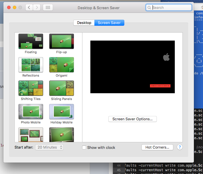

Hey all,
Noticed there are a couple threads on here about setting screensavers. Below is a screenshot after running the script. I have not had much luck with 10.11.4 and the following script:

All those /usr/bin/defaults -currentHost style commands are not going to work. -currentHost means the ~/Library/Preferences/<some plist> path of the user running the script, which in the case of one run from Casper will be root. You need to change all of those to start with to affect the logged in user.
There may be other problems with it other than that, but that was the first thing that struck me about it.

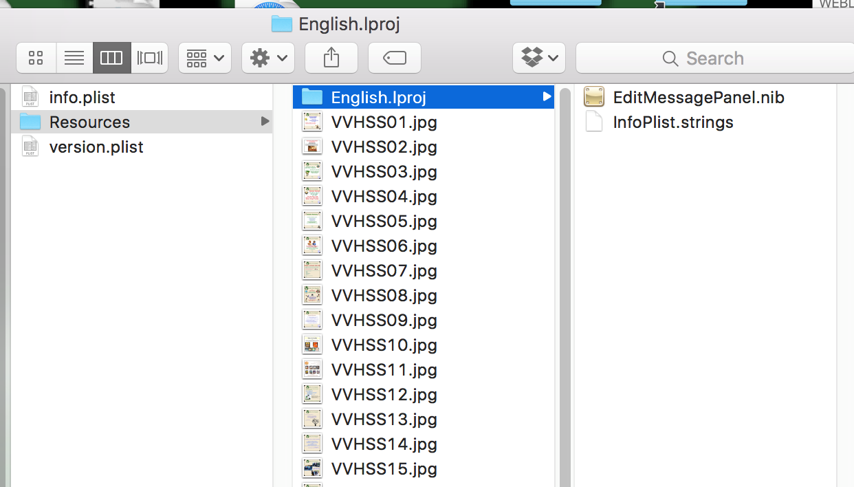

Ok so im thinking of another approach... anyone have experience with using Xcode to create .saver packages?
I also saw this article on how to manually create a .Saver package(outdated im guessing) and created this(gave me null error when trying to install):
@Josh.Smith I tried this script using a .saver but screensaver activates using Quartz composer. Also, doesn't "select" my custom saver, even though it activates it. How can I do this with a .saver?
@wmateo I have only used it with a .qtz, but I think you just need to change the type string value from 1 to 0 at the end of the defaults command:

@Josh.Smith I was able to recreate this script you referenced above using a .saver bundle. I removed the type -int 0 at the end of the defaults write command since I was not using a .qtz file.
Note that this script also requires a logout or reboot since it's grabbing the preference of the user templates.
