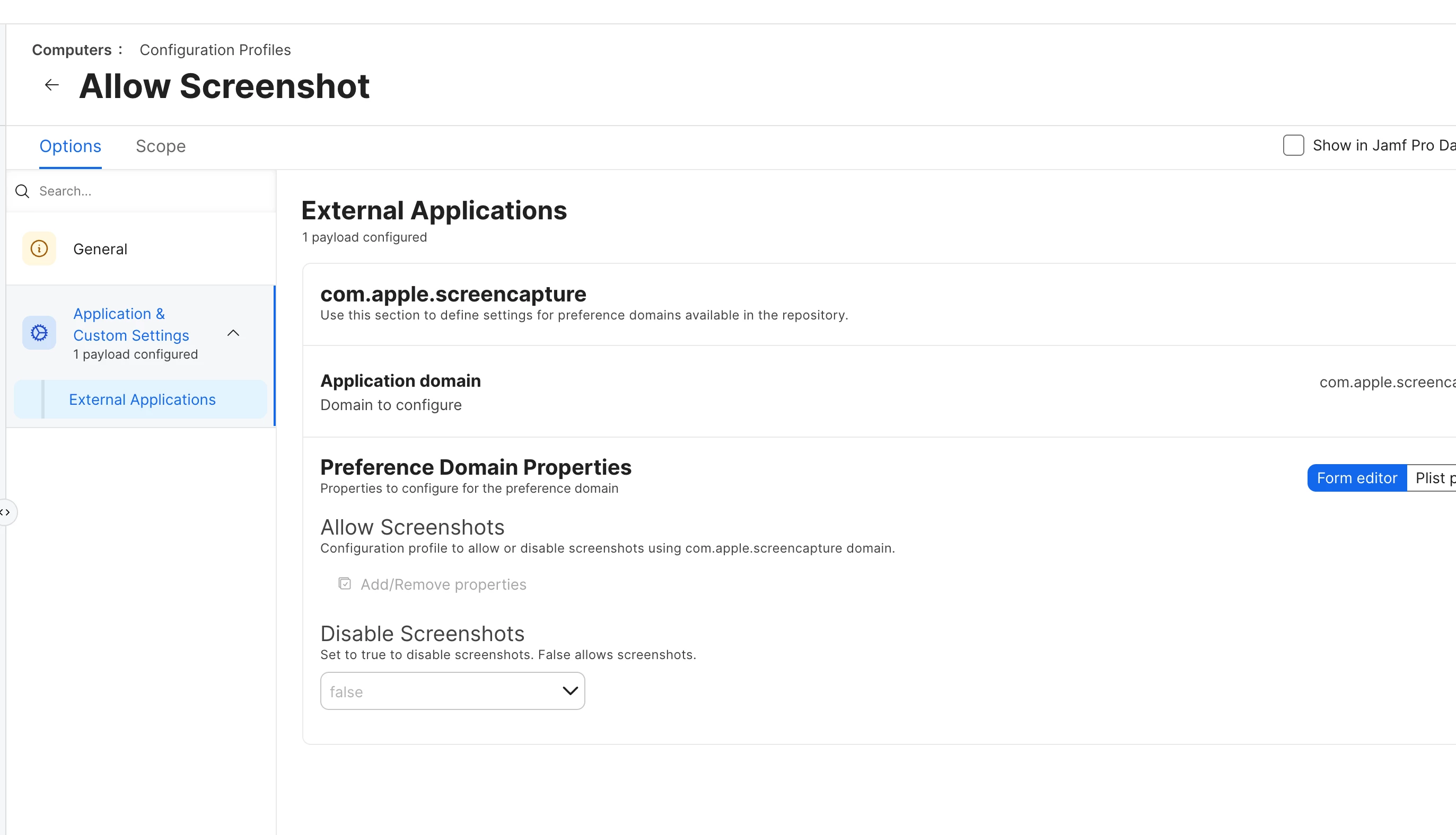

I have managed to create a custom schema for allow screenshot  it also meant creating something to allow screensharing so I could reach me machine onsite.
With both of those applied and removing the orginal profile it still wont work.
Shift-Command-4 just wont do anything

@tdenton I just reviewed this thread, and I initially missed your comment about being on VNC when seeing this behavior. That definitely could have an impact on the shift-command-4 capture process but short of trying it while hands-on with a Mac it's not working on I don't know how you can be sure.
I'll also mention this is how you can check for dueling Configuration Profiles applying the same setting (credit to jmahlman posting an example of this query on Mac Admins Slack):
sudo /usr/bin/osascript -l JavaScript << EOS $.NSUserDefaults.alloc.initWithSuiteName('com.apple.screencapture').objectForKey('keyForDisablingScreenshots').js EOS
Substitute the actual key name of the Disable Screenshots key for keyForDisablingScreenshots (it isn't an option in the copy of the com.apple.screencapture.json file I'm using.
