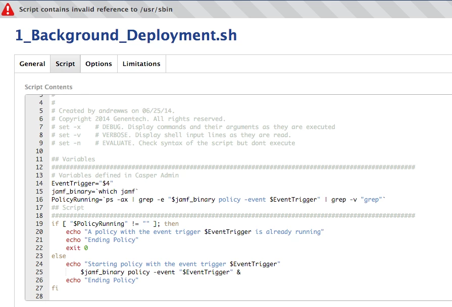

Script contains invalid reference to /usr/sbin Alert is inaccurate
  • October 6, 2015
  • 10 replies
  • 45 views
After looking through the scripts that were red flagged post upgrade to 9.81 it appears that the alert is inaccurate at best and does not have an obvious way to have it recheck.

Its odd that it would have flagged that script, if in fact the image above is how the script was pre upgrade. But just click the Dismiss button to the far right of the alert section on top. The alert will go away.

That's weird @mm2270, I never had a "Dismiss" option... I just cloned the script and it went away.

Hey @andrewseago
Thanks for posting this. I'm not sure what the scan saw in the script that thought it needed updating. The scan looks at literal text vs actually executing something and analyzing it's output. We can take a look at it here.
Regarding rescanning - we didn't add a rescan function in. We basically wanted it to scan it once, show where there is potential changes needed, and then stop scanning. The decision was mostly made to not add the expense of scanning on a regular basis. Our thoughts were that changing the path is top of mind for this short time frame, but then won't need to happen again so didn't want to add functionality to continuously scan.
Let us know if there are some other issues we need to look into there. Thanks!

I had one like that where the script wasn't wrong. I dismissed it.
There should have been a "re-check" command/button to make sure you'd gotten everything.
I think these are the MySQL commands they are using. Don't try this if you're not comfortable with the MySQL command-line interface:
select script_id, file_name from scripts where script_contents like "%/usr/sbin/jamf%";
select policy_id, name from policies where run_command like "%/usr/sbin/jamf%";

Has anyone else noticed the notification appear when both /usr/sbin/jamf and /usr/local/bin/jamf appear in the script? That’s a slightly different kind of inaccuracy.
