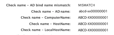

The script works great...except that it reports a MISMATCH if the tech bound using lower case vs upper case characters.
Is there a tweak to the above script that will stop reporting MISMATCH if AD bind name is in lower case, but ComputerName is in upper case (or vice versa)?
