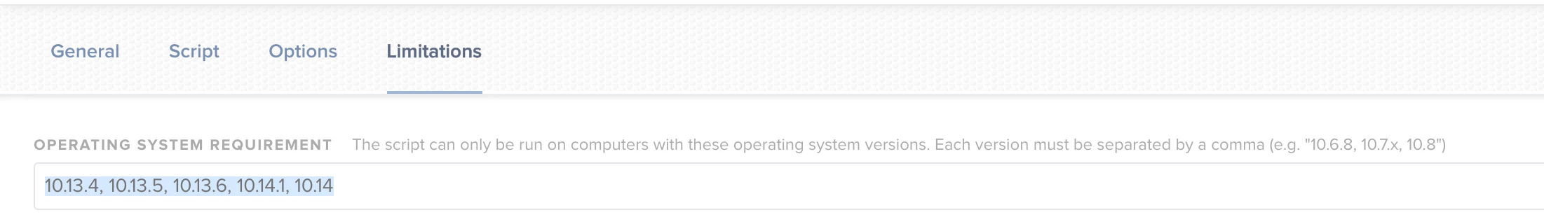

I have a numb question that we have never actually dealt with in the past.
We are trying to limit a script to only those devices that meet certain OS values. I have the limitations set to: 10.13.4, 10.13.5, 10.13.6, 10.14.1, 10.14.
Wondering if I enter in 10.14 or 10.14.x will that perform the same thing as having to write the 10.14.1, 10.14.2, 10.14.3... so that when time comes I don't have to go in and change the values to search for that criteria as well?

Yeah, 10.14.x,10.13x,10.12.x etc will do the trick.
