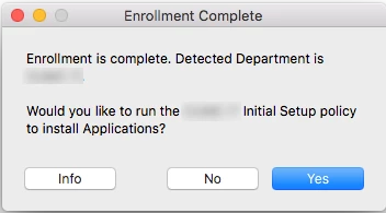

function enrollmentCompleteWindow () {
# Create a temp conf file to prompt user
rm $configDest
cat <<EOT >> $configDest
*.title = Enrollment Complete
txt.type = text
txt.default = Enrollment is complete. Detected Department is ${compDept}.[return][return]Would you like to run the ${msgPolicy} Initial Setup policy to install Applications?
txt.width = 310
txt.height = 310
cb.type = cancelbutton
cb.label = No
b.type = button
b.label = Info
db.type = defaultbutton
db.label = Yes
EOT

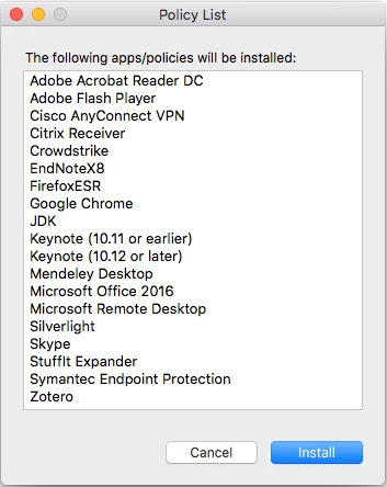

function appListWindow () {
# Create a temp conf file to list apps
rm $configDest
*.title = Policy List
tb.type = textbox
tb.label = The following apps/policies will be installed:
tb.default = $appString
tb.width = 310
tb.height = 310
tb.disabled = 1
cb.label = Cancel
db.label = Install
EOT
if [[ "$enrollButton" == *"cb=1"* ]]; then
    echo "user clicked no"
elif [[ "$enrollButton" == *"db=1"* ]]; then
    echo "user clicked yes"
    #$jamf_binary policy -trigger $initialSetup
elif [[ "$enrollButton" == "b=1"* ]]; then
    echo "user clicked info"
    appListWindow
    if [[ "$appListButton" == *"cb=1"* ]]; then
        echo "user clicked cancel"
    elif [[ "$appListButton" == *"db=1"* ]]; then
        echo "user clicked install"
        #$jamf_binary policy -trigger $initialSetup COMMENTED OUT WHILE TESTING
