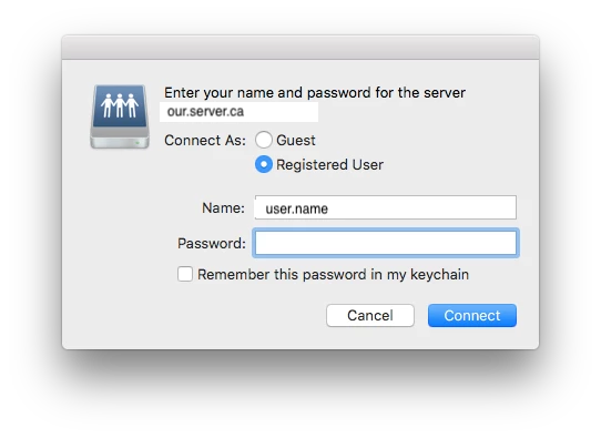

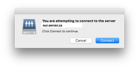

Hey Guys, I'm trying to silently mount a network share on login without the user having to authenticate. Our computers are bound to AD and use mobile accounts (with all syncing disabled). I'm using a LaunchAgent which runs a script.
Here's what's happening:
Everything works reasonably well on the first login. It creates the account and when I reach the desktop I get a pop-up that says "you are attempting to connect to the server "server.name.com", and I click the blue "connect" button and the share mounts. Sweet! Here's a screenshot of this:
However, every login afterwards prompts for a password... Here's another screenshot:
So, I don't know why it's authenticating the first time and then not authenticating for all subseqent logins. Here is the script that I'm using:

I tried using mount -t smbfs as well, but it just silently fails to mount the share. When I run it in terminal (as the user) it prompts for a password...
I've also noticed that it prompts for a password when I try to connect via Finder (using the "connect to server" dialogue).
I tried using the "mountNetworkShare" script from the "resource kit" and does the same as when I use mount -t smbfs (it just silently fails).
I used the ticket viewer app to verify that the user has a kerberos ticket.
I'm wondering if this might be a 10.13 issue?
Any help or suggestions would be appreciated. I don't know what I'm doing wrong.

I am mounting using this (as part of a much longer script your welcome to see if you need).
sudo -u $Current_User osascript -e 'mount volume "'$True_Path'"'
$True_Path is in the form smb://user@server/share
It certainly seems to work pretty seamlessly, although on 10.13 or later you also have enable allow connections to unknown servers.
defaults write /Library/Preferences/com.apple.NetworkAuthorization AllowUnknownServers -bool YES
Otherwise new users will be prompted to approve any new servers.

So, still no love.
Setting the AllowUnknownServers key stopped the first pop-up (with the blue "connect" button) from appearing, and the share just mounted silently (which is awesome), but it still prompts me for a password on every login afterwards...
  • August 16, 2018
So, it turns out that part of the problem was the test user that I was using.
I decided to try some testing with a production user, and things work much better now. I think this issue is solved.
Thanks everyone for the help.
