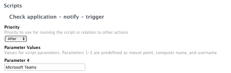

I couldn't get your script to work from the JSS, with "Microsoft Teams" as the $4 parameter, as a test if i run the script locally (changing kill_list = "Microsoft Teams") it works, i think there's something going on with pulling that parameter when running the command as a user.
I've managed to get my script working by creating a separate script from within the main one, the script is created on the fly and then run as the user, this pulls the parameter from the JSS and quits the application successfully, on the JSS it needs to be set without quotes, i pinched the idea from @mm2270 here

It could be because jamf always passes the first 3 parameters in every script so you might need to add this
boot_drive = sys.argv[1]
computer_name = sys.argv[2]
username = sys.argv[3]
kill_list = sys.argv[4].split(',')
You can also try running it with sudo jamf runscript -script script_name.py -path /path/to/script -target / -p4 "Microsoft Teams" to see if that makes any difference. I know there are issues passing parameters sometimes since Jamf always passes all 11 parameters even if you do not use them in a script
