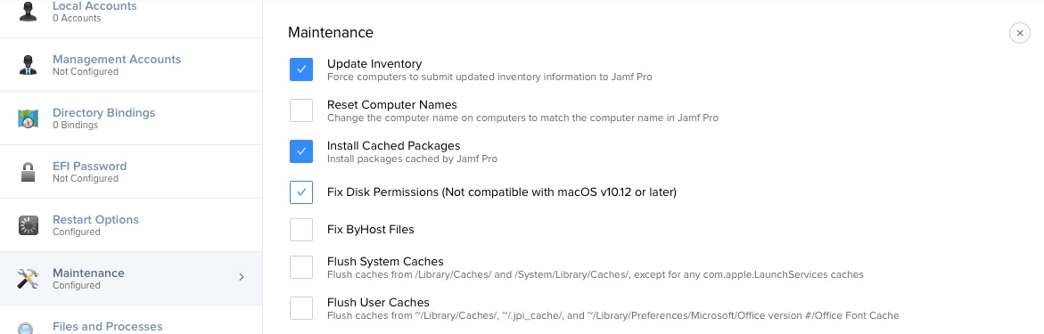

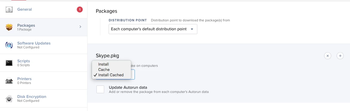

This may be helpful as well. You can deploy a policy with "Install Cached" which will do exactly what your script is doing. Additionally you can select "Install Cached Packages" from the Maintenance payload which will install all items in the Waiting Room.
