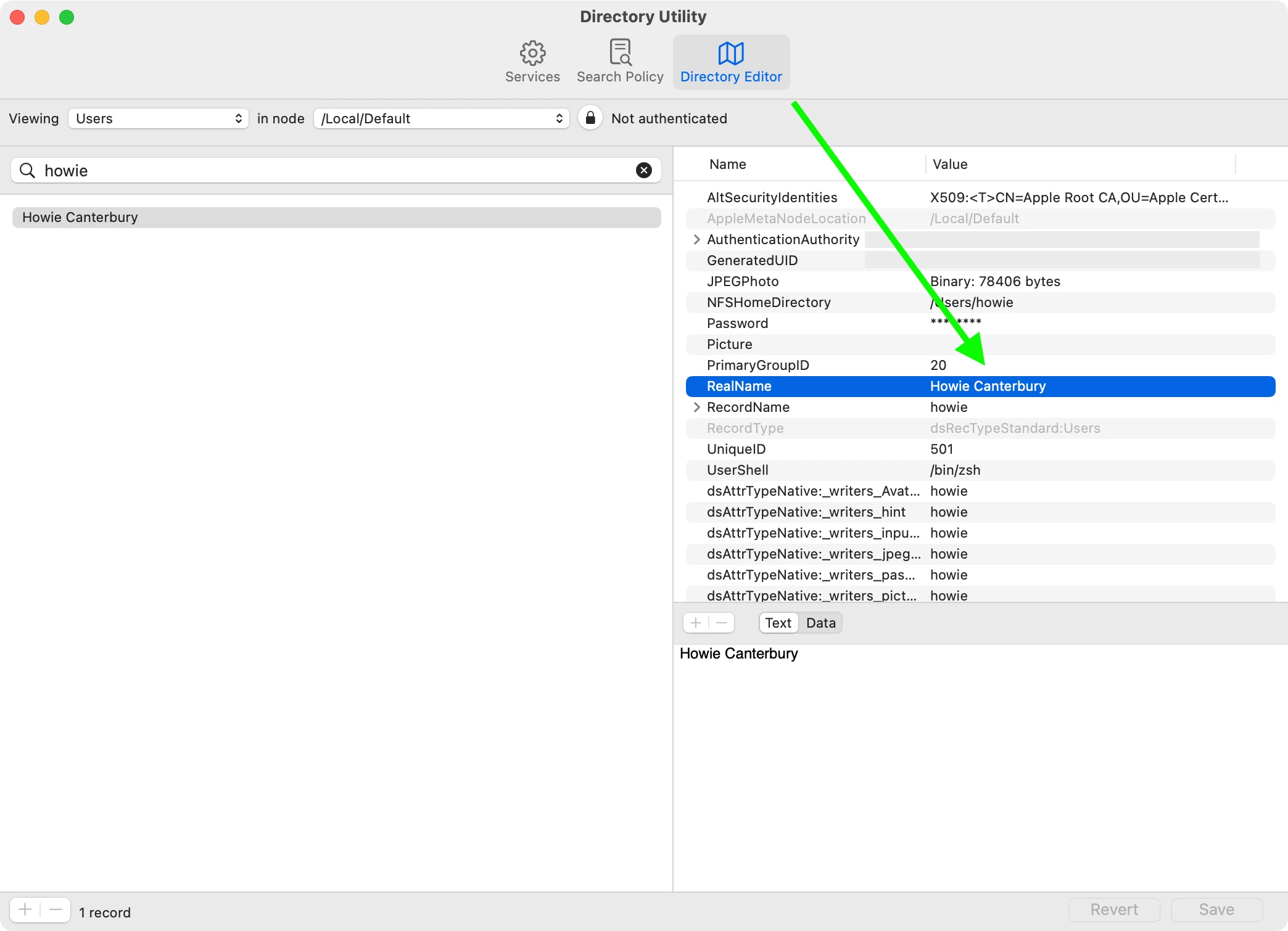

It doesn't know to do that. It's querying the first and last name that is in the user's local directory record. My script is looking at the "RealName" attribute. Here's a screenshot from my personal MacBook Pro. You could experiment with using awk or some other method of parsing output to remove a middle name from the output.
