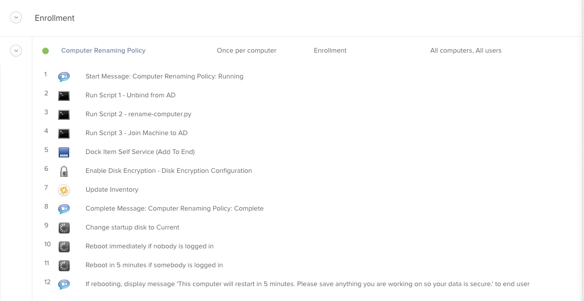

Not sure if this adds any value but I have a policy that ties x3 separate scripts creating the computer name for my Organization.
The rename-computer.py script pulls from a .CSV that is located anywhere of your choosing. That file has a list of all your computers by Serial Number and what you want the computer name to be.
You can read all about it here: Automatically Renaming Computers from a Google Sheet with Jamf Pro
I have spoken with @haircut some time ago that stated he may or may not change the script to a .zsh in the future but no developments there. You can always subscribe to his GitHub and watch for any changes like I have. But as of right now this has been working flawlessly with every version of MacOS I have tested including 10.15.2
