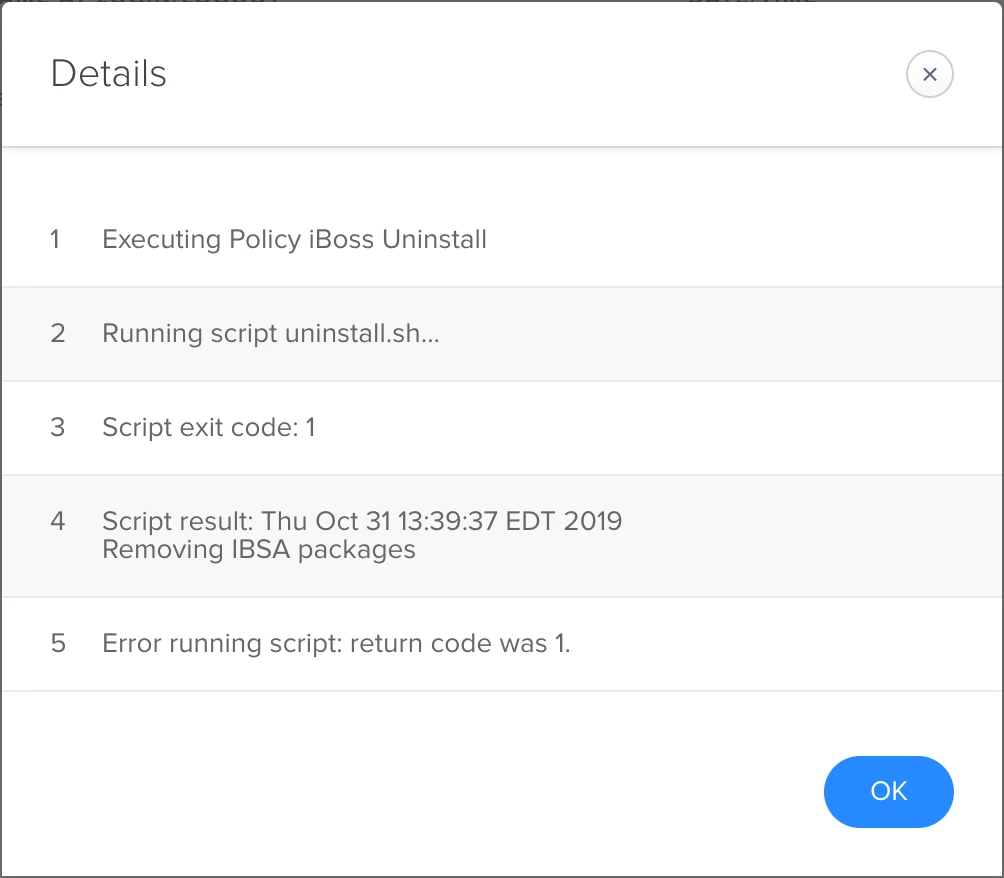

When trying to run an uninstall script for our content filter (iBoss), it fails when running via Policy. However, if you login with a local administrator account and run the script on the machine itself... it works fine.
Here is the error:
If I echo out the majority of the commands, I narrowed the failure down to the certificate removal.
Here is the content of the script:

Any help would be appreciated.
Best answer by sirsir
I was able to get it to work by using only these bits:

So where did you see the script was failing? Do you mean at this line:
sudo rm  -f "/usr/share/ca-certificates/iboss.crt"
Or was it at this line near the end?
sudo rm -f /etc/pki/ca-trust/source/anchors/iboss.crt
Those are the only places I see it trying to delete a certificate.
BTW, I know you didn't make that script, but whoever did, they should know that all those dozens of sudo's are totally unnecessary. When an entire script runs as root or with sudo, you typically never have to include specific sudo's within the script itself. There are some exceptions, but none of the above cases are such exceptions.
  • November 5, 2019
This section right here:
FILE=/Applications/Utilities/iboss.app/gen4agent/iboss.crt
  if [ -f "$FILE" ] && [ -s "$FILE" ]; then
    CERT=$(openssl x509 -noout -subject -in $FILE | grep -o "CN=.*/" | awk -F '[=/]' '{ print $2 }')
    security find-certificate -c "$CERT" -a -Z | sudo awk '/SHA-1/{system("security delete-certificate -Z "$NF)}'
And I know! From what iBoss said, it's just a generic catch-all script. Not an excuse though. I just want this stupid thing to work so I don't have to manually remove the iBoss connector on 1200 machines.
