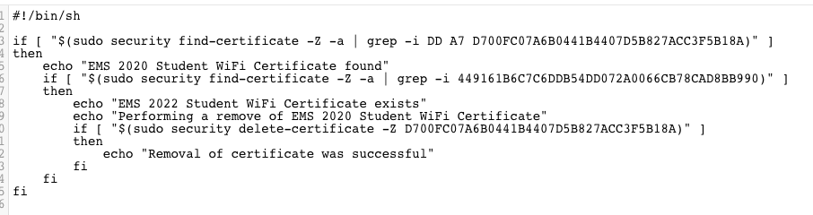

I know this is a little late to the party, but just experienced the same cert issues at my new job. Here's what I used (similar to those commenting above). It looks at sha-1 and has some logic to determine if it has the new one before removing the old one. Worked out really well for me. Good luck!
