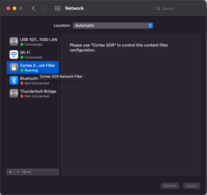

Is it possible to search on the existence of a network service? I'm thinking of an extension attribute or smart group or something of the like.
We specifically want to track if the Cortex network service called "Cortex XDR Network Filter" is installed.

Thank you IamGroot. You are correct that it doesn't show up because it is a Content Filter. That did give me a lead though. I found some other people asking the same thing, but no clear solution yet. It did give me a better way to phrase the question at least.
