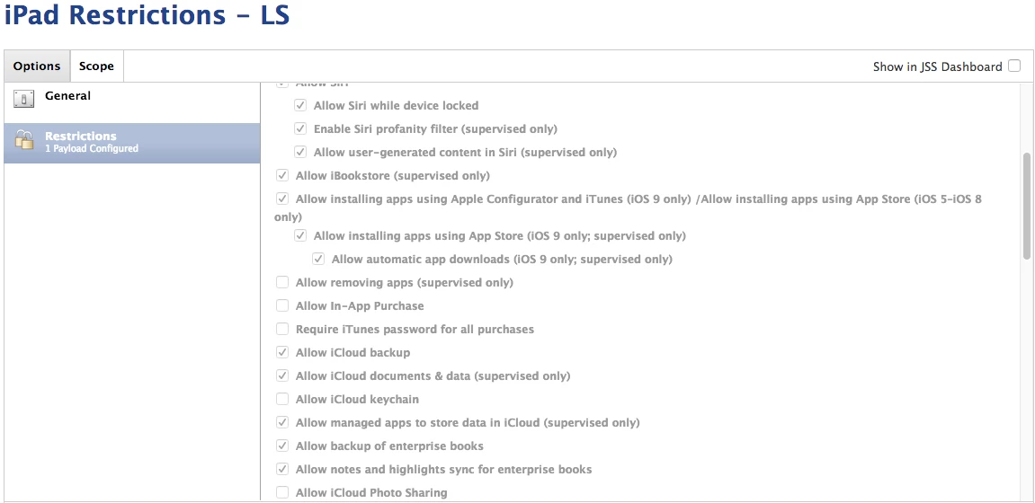

I think you have to have iPad restrictions deployed to the devices with "Require iTunes password for all purchases" unchecked. We were having issues the other day and I realized the restrictions policy wasn't scoped to our lower school iPads, so they were prompting for passwords for each install. Once I scoped the restrictions policy to those iPads, the apps installed without passwords.
Granted this was the other day on JSS 9.8, so it may or may not help you with your 9.81 app deployments without iTunes accounts.
Here's a screenshot of the relevant restriction settings we send to our lower school iPads:
