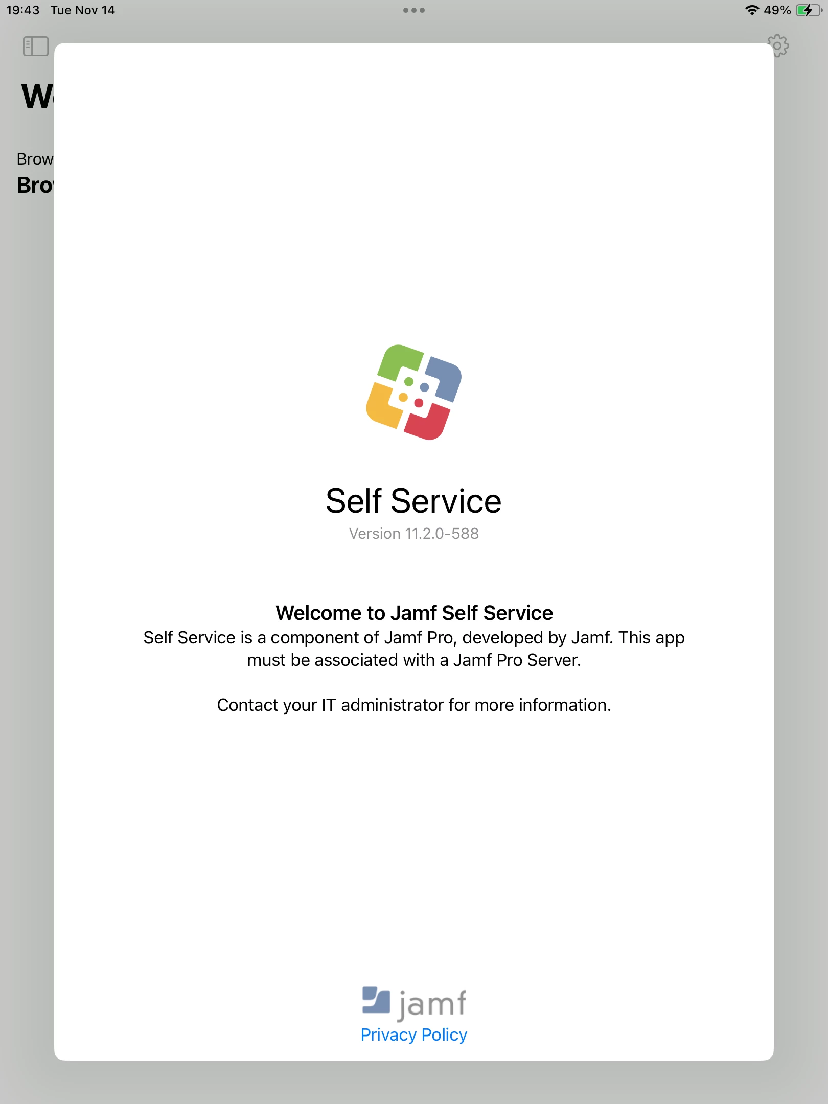

After installing Self Service (ver11.2.0-588) to managed iPad device, the app requests log in to JAMF Software Server.
This happens iOS 16.6.1 and 17.1.1, then it's possible to access internet.
Even after reseting iPad, reinstall App, it occurs.
I have no idea to solve it.
Help me.

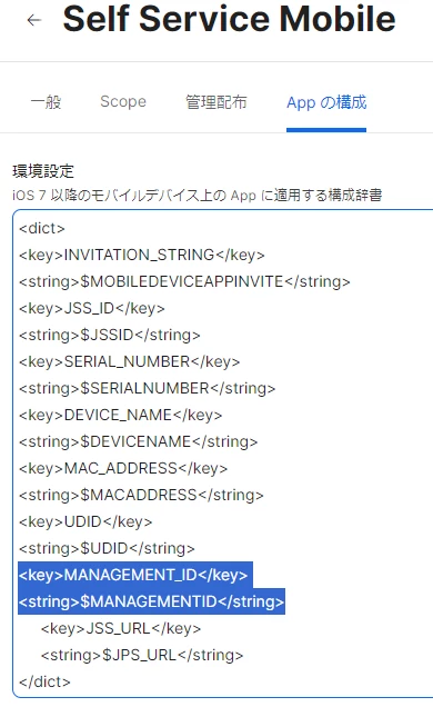

In my environment, I was able to work around this by adding the following to the app configuration of the Self Service Moblie App.
<key>MANAGEMENT_ID</key>
<string>$MANAGEMENTID</string>

Initially we replaced UDID with MANAGEMENTID which didn't work, needed to have them both in the config.
Jamf told me that they have an open case for this: #PI115080

Im still getting the error after adding this to the Self Service App Config. This issue is so annoying.
<dict> <key>INVITATION_STRING</key> <string>$MOBILEDEVICEAPPINVITE</string> <key>JSS_ID</key> <string>$JSSID</string> <key>SERIAL_NUMBER</key> <string>$SERIALNUMBER</string> <key>DEVICE_NAME</key> <string>$DEVICENAME</string> <key>MAC_ADDRESS</key> <string>$MACADDRESS</string> <key>MANAGEMENT_ID</key> <string>$MANAGEMENTID</string> <key>JSS_URL</key> <string>$JPS_URL</string> </dict>
vickih
  • Nov 15, 2023 3:04 PM UTC
Matt this is what worked for me the UDID string needs to be added back which is not in the Jamf Admin Documentation.
change the $JSS_URL string to match your https://xxxx.jamfcloud.com instance.
<dict>
<key>JSS_ID</key>
<key>UDID</key>
<string>$UDID</string>
<key>JSS_URL</key>
<string>$JSS_URL</string>
</dict>
