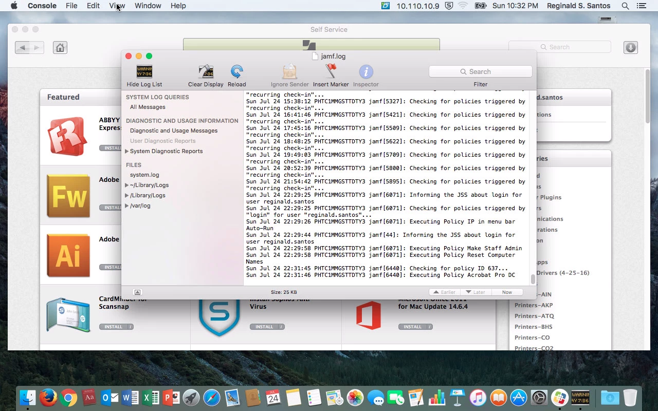

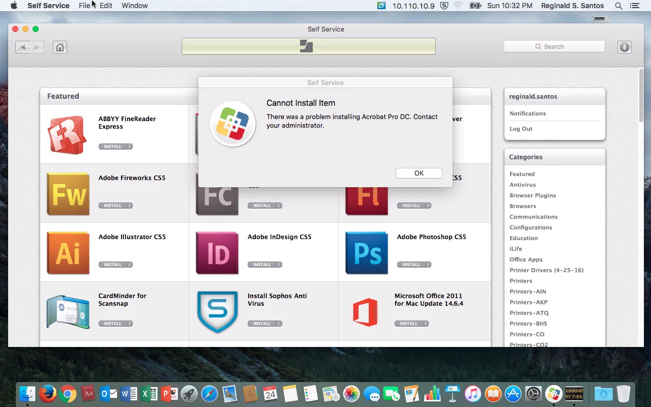

We are having trouble this year with our Self Service. We upgrade to JSS 9.92. When we log in as local admin user, we can install packages using self service. ut when we log in as a network user, Self Service opens, but is failing to install package. I receive Cannot Install Item, please contact your Administrator. Logs are not helpful, it just logs the exact error but no explanation. But I think it is failing to the point of Mounting the DP. I can access the DP using Command K and get to the Packages, copy it to the Desktop and install it no problem. But it wouldnt install on SS. Removed JamfFramework, no go, re image, still no good. We do not use JDS, just AFP DP. Please help.

What I am noticing in the logs is Self Service is logging in as the logged in user. Correct me if I'm wrong but doesnt it should use the credentials we put in the JSS?
  • July 26, 2016
This is the logs from the DP. AFP Log below shows successful Self Service (When logged in as a Local Admin user)
This one below is Failed Self Service (When logged in as a Domain User)
