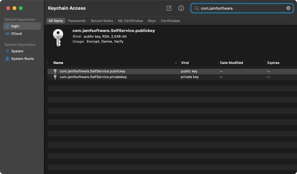

What do you see if you query the Jamf Pro server using Terminal?
ex. "dig jss.jamfproserver.com"
Does it return the expected information? I have never used Self Service for AD binding but I wonder if the Jamf public keys in Keychain have been damaged.
com.jamfsoftware.SelfService.publickey
com.jamfsoftware.SelfService.privatekey

If the two keychain items I mentioned before are corrupted Self Service won't work at all. Deleting them and then re-enrolling should fix that.

@howie_isaacks thanks for the suggestions. Everything looks fine in Terminal, and I've also tried deleting those 2 keys, reinstalling Self Service and still no luck. Once it is reinstalled it still has the offline error.
