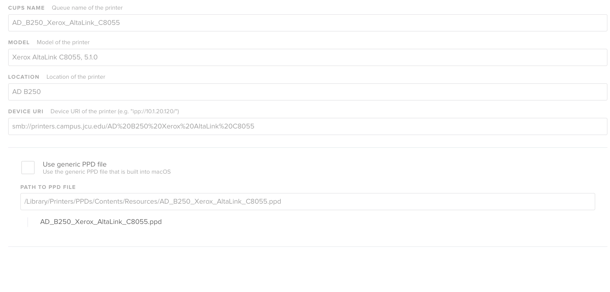

We make printers available in Self Service on an as needed basis currently (as there is no way to connect our print server and Jamf). We had much success in Mojave with the following:
-For our HP Printers and Kyocera Printers we deploy it as a generic post script printer.
-For our Xerox Printers we deploy the drivers from Xerox.

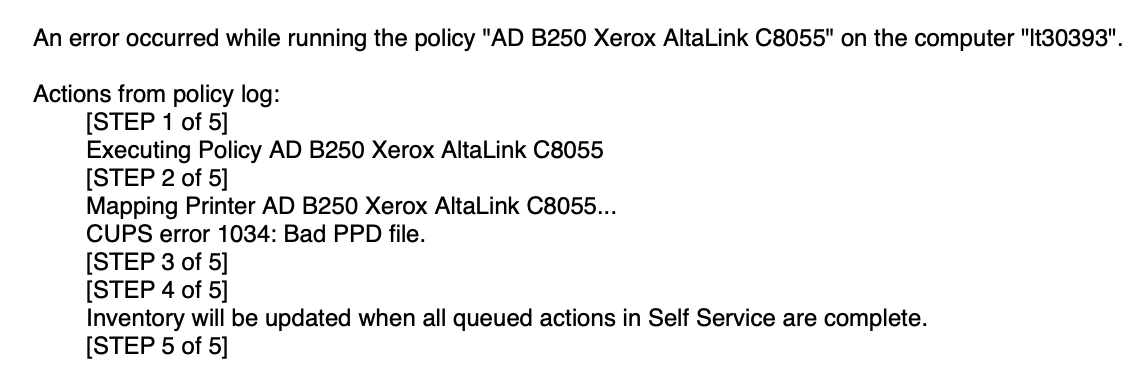

We have run into many issues with Xerox on Catalina and I can't figure out the issue. It is saying the following. We are Windows print server if that helps!
Should the PPD in Jamf be the path to the Xerox one? It is a .GZ so I am not sure how to get those to PPDs.
Any help is much appreciated! I attached the email failure and the current policy.

First thought that comes to mind is checking whether you’ve dealt with authentication issues perhaps?
  • January 22, 2020
We have had to update Xerox drivers for Catalina. And reset the printing system before re-adding the printer in System Preferences.
  • January 23, 2020
Have you checked to make sure the xerox drivers even support catalina... ive had bad luck with some of the xerox drivers. On a side note we now use Papercut for macos printing, it solves issues like this.
