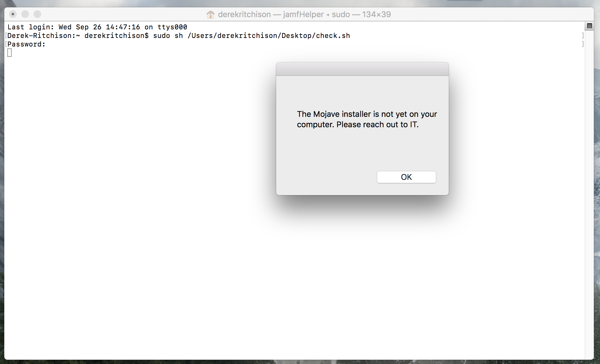

Ok. The hash is probably a better way of checking once I get it solved, but it still just hangs when I run the Jamf script. The thing is, the below script works perfectly when I run it in Terminal:
description="The Mojave installer is not yet on your computer. Please reach out to IT."
button1="OK"
jamfHelper="/Library/Application Support/JAMF/bin/jamfHelper.app/Contents/MacOS/jamfHelper"
icon="/path/to/icon"
if [[ ! -d "/Applications/Install macOS Mojave.app" ]]; then
"$jamfHelper" -windowType utility -description "$description" -button1 "$button1"
else
echo "Beginning upgrade process..."
If I temporarily change the name of the installer in /Applications I get the error. If I change it back I get the "Beginning upgrade process..." echo. I did have to run the script as sudo though, could that be the issue?

When I run the script locally in Terminal it works as I'd expect. I do have to run it as sudo and enter a password though. Could that be what is causing Self Service to hang? If so, is there a way around having to enter a password?
In case anyone is curious I finally got the script to work. Yesterday I noticed that it actually was working fine on other test machines, so I thought that maybe it was failing on my own because I actually did have the installer in my /Applications folder, but I just re-named it. After deleting the app entirely it worked. Odd, but we're in business. Now I only have to fine tune my Smart Group so that the installer doesn't cache if the user happens to be using, say, a hot spot or is on an otherwise undesirable WiFi network --- coffee shop, airport, et cetera. Any suggestions there would be great.
