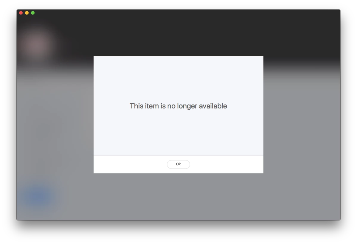

nvandam
Anybody know why this is happening? The same policy I'm running to get this result works on other computers. I've restarted, re-enrolled, updated inventory. Same result.

Is it set to once per computer? Perhaps clear self-service cache and/or remove JAMF framework before re-enrolling.
  • Nov 28, 2017 5:49 PM UTC
I experienced this yesterday too. It only occured on a policy I had sert to cache (Make available offline). I unchecked that option and it has been working fine since. Not sure if you are experiencing the same
  • Nov 29, 2017 6:21 PM UTC

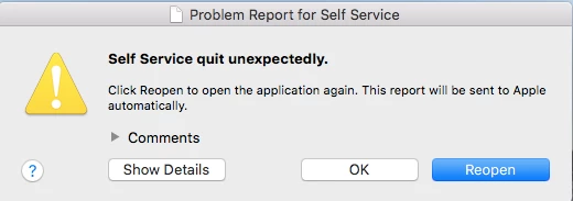

I've tried clearing cache, changing the cache options with this and it still fails to install the software I'm trying to install. Two days ago it ran fine. Now today, fail. Any ideas?
Self Service seems to think it's installed. If I try to reinstall it crashed Self Service.
  • Nov 29, 2017 8:42 PM UTC
We just experienced this as well.
Yesterday I was running self-service policies on a MBP cart of about 30 machines and all but one of the machines in the cart was able to apply the self-service policies, the one that could not apply the policy started showing that same message "This item is no longer available"
Everything on the backend looks good though, machine entry shows up on pending on the policy logs and policy shows up in self service but weird it does not run especially since it worked on the other machines...
UPDATE: Had a ticket with Jamf to get them some logs, so walked over to the machine in the cart and tried running the Self Service policy, and sure enough, it worked with no issues, classic...
