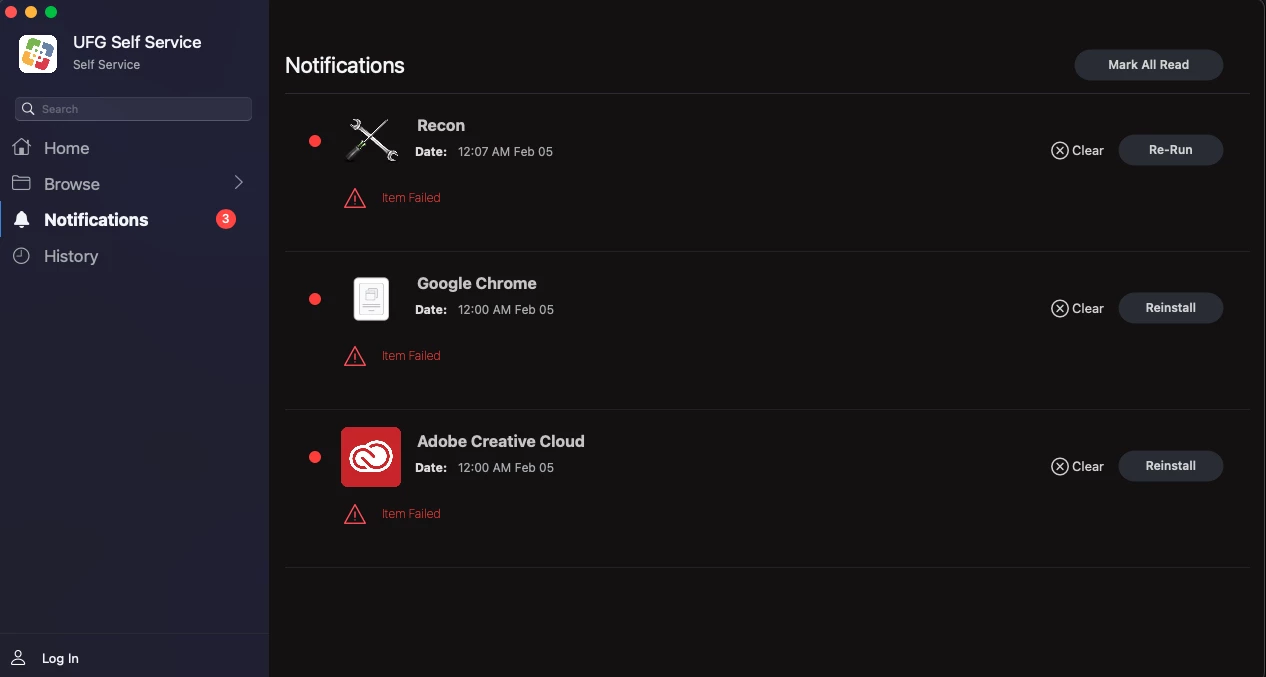

Since the self service update (updated on my M2 test machine today) my non VPP items in self service are generating false negatives "item failed" errors. Even a simple inventory update will generate a false negative. They execute fine but users will absolutely report these false negatives believing them to be actual negatives.  This doesn't appear to be true for all macs (seems to be fine on my intel)
What are my next steps?
Thank you

running a inventory update from self service a few times (false negative fails) this is what jamf.log is showing>>
Sun Feb 05 10:11:22 W66W257JPQ jamf[8496]: Executing Policy Recon
Sun Feb 05 10:11:22 W66W257JPQ jamf[8496]: Inventory will be updated when all queued actions in Self Service are complete.
Sun Feb 05 10:11:40 W66W257JPQ jamf[8563]: Removing existing launchd task /Library/LaunchDaemons/com.jamfsoftware.task.bgrecon.plist...
Sun Feb 05 14:06:20 W66W257JPQ jamf[545]: Removing existing launchd task /Library/Application Support/JAMF/tmp/com.jamfsoftware.task.policy.startup.plist...
Sun Feb 05 14:06:21 W66W257JPQ jamf[545]: Removing existing launchd task /Library/Application Support/JAMF/tmp/com.jamfsoftware.task.policy.startup.plist...
Sun Feb 05 14:06:21 W66W257JPQ jamf[545]: Removing existing launchd task /Library/Application Support/JAMF/tmp/com.jamfsoftware.task.startssh.plist...
Sun Feb 05 14:06:23 W66W257JPQ jamf[950]: Upgrading jamfHelper.app...
Sun Feb 05 14:06:23 W66W257JPQ jamf[950]: The checksum of /Library/Application Support/JAMF/tmp/jamfHelper.app/Contents/MacOS/jamfHelper did not match. (ea2a2bb5a8df1b4e961c52f4a2cb8140 != 1290fb19780832ae8e23a4407fd3cfda)
Sun Feb 05 14:06:23 W66W257JPQ jamf[950]: Upgrading JAMF notification service...
Sun Feb 05 14:06:24 W66W257JPQ jamf[950]: The checksum of /Library/Application Support/JAMF/tmp/Management Action.app/Contents/MacOS/Management Action did not match. (5073615e23c918c3ab8ceaf1e4b40a9a != 11ba83f688a45f7ef91283ace903fa41)
Sun Feb 05 14:06:24 W66W257JPQ jamf[950]: Checking for policies triggered by "startup" for user "trandall"...
Sun Feb 05 14:06:24 W66W257JPQ jamf[1011]: Checking for policies triggered by "login" for user "trandall"...
Sun Feb 05 14:18:57 W66W257JPQ jamf[1594]: Upgrading jamfHelper.app...
Sun Feb 05 14:18:58 W66W257JPQ jamf[1594]: The checksum of /Library/Application Support/JAMF/tmp/jamfHelper.app/Contents/MacOS/jamfHelper did not match. (ea2a2bb5a8df1b4e961c52f4a2cb8140 != 1290fb19780832ae8e23a4407fd3cfda)
Sun Feb 05 14:18:58 W66W257JPQ jamf[1594]: Upgrading JAMF notification service...
Sun Feb 05 14:18:58 W66W257JPQ jamf[1594]: The checksum of /Library/Application Support/JAMF/tmp/Management Action.app/Contents/MacOS/Management Action did not match. (5073615e23c918c3ab8ceaf1e4b40a9a != 11ba83f688a45f7ef91283ace903fa41)
Sun Feb 05 14:18:58 W66W257JPQ jamf[1594]: Checking for policy ID 50...
Sun Feb 05 14:19:00 W66W257JPQ jamf[1594]: Executing Policy Recon
Sun Feb 05 14:19:00 W66W257JPQ jamf[1594]: Inventory will be updated when all queued actions in Self Service are complete.
Sun Feb 05 14:19:24 W66W257JPQ jamf[1663]: Removing existing launchd task /Library/LaunchDaemons/com.jamfsoftware.task.bgrecon.plist...
Sun Feb 05 14:24:06 W66W257JPQ jamf[1936]: Upgrading jamfHelper.app...
Sun Feb 05 14:24:06 W66W257JPQ jamf[1936]: The checksum of /Library/Application Support/JAMF/tmp/jamfHelper.app/Contents/MacOS/jamfHelper did not match. (ea2a2bb5a8df1b4e961c52f4a2cb8140 != 1290fb19780832ae8e23a4407fd3cfda)
Sun Feb 05 14:24:06 W66W257JPQ jamf[1936]: Upgrading JAMF notification service...
Sun Feb 05 14:24:06 W66W257JPQ jamf[1936]: The checksum of /Library/Application Support/JAMF/tmp/Management Action.app/Contents/MacOS/Management Action did not match. (5073615e23c918c3ab8ceaf1e4b40a9a != 11ba83f688a45f7ef91283ace903fa41)
  • Feb 5, 2023 8:52 PM UTC
appears to be plenty of checksum errors appearing in the jamf log after Sat Feb 04 04:22:17
and
