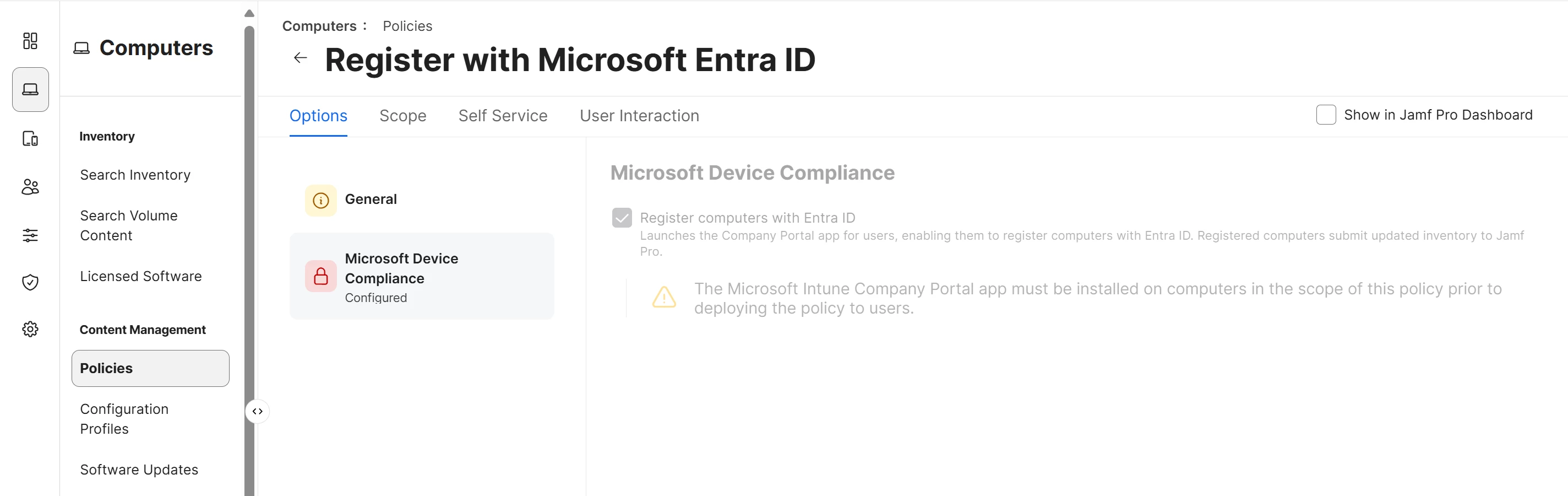

dmccluskey
  • Jul 17, 2025 8:08 PM UTC
You should not be opening company portal and signing in directly that way.
You need to run the registration through a self-service policy and that will login and launch company portal for you.

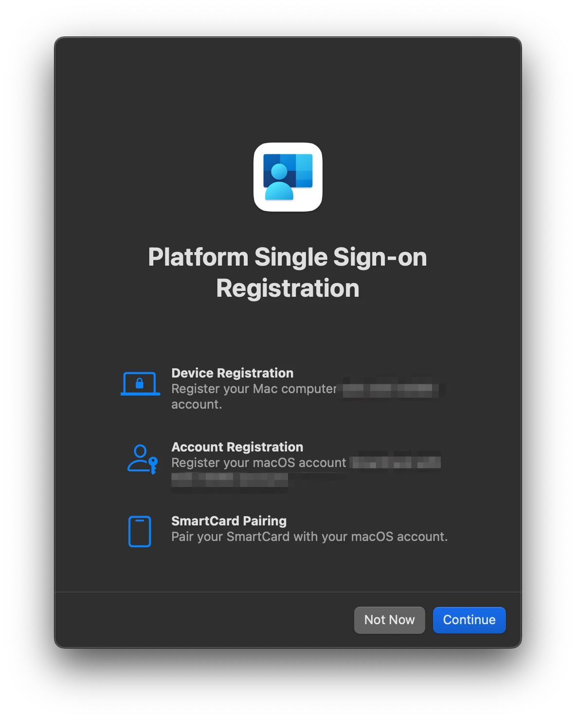

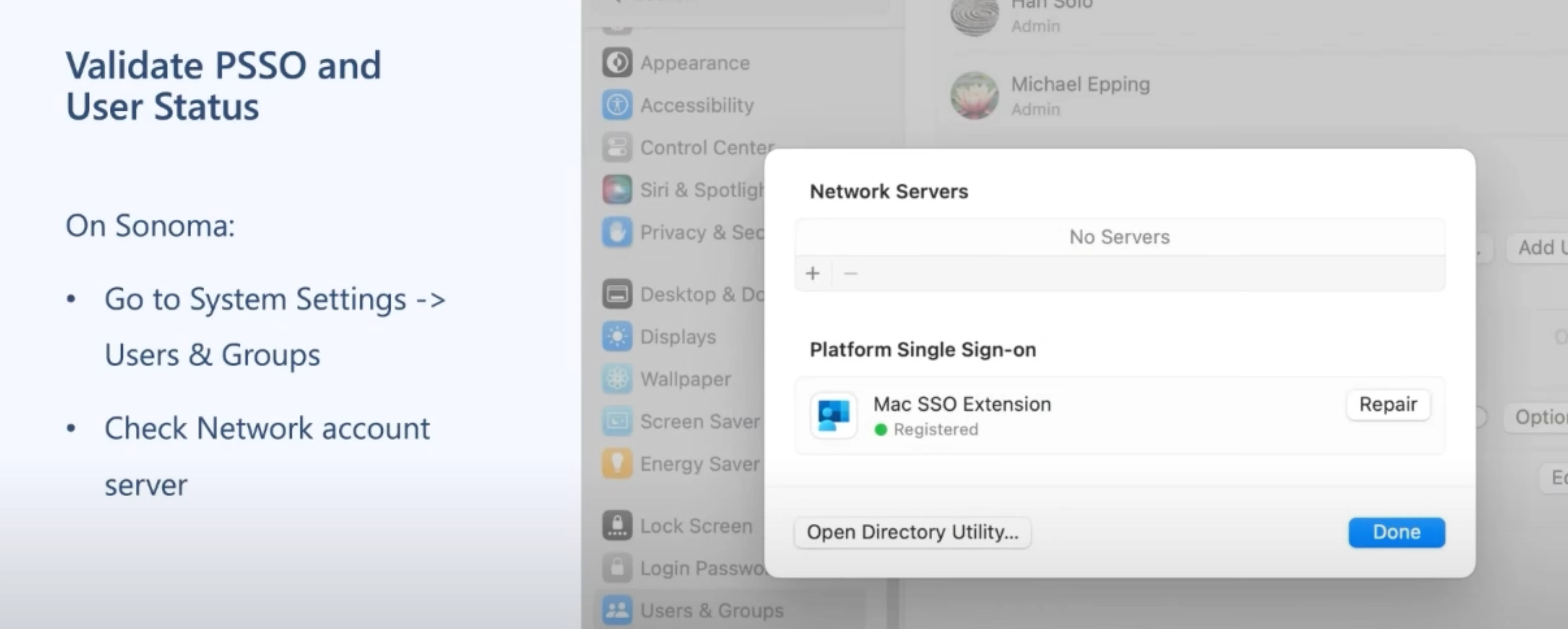

mvu
  • Jul 18, 2025 2:19 PM UTC
Just out of curiosity, would rolling out Microsoft Platform SSO be beneficial here? Tackle to two birds with one stone, which would include sending compliant information to Intune?

mvu
  • Jul 18, 2025 7:06 PM UTC
Yes, I understand.
What I’m saying is why not move to Microsoft PSSO now? You can take advantage of the benefits of Microsoft PSSO + Device Complance in one registration.
This may also give your users a better experience with the registration.

Hi ​@ozkanyavuzun, I went through this process about two years ago. What the other users have directed is correct.
https://learn.jamf.com/en-US/bundle/technical-paper-microsoft-intune-current/page/Creating_a_Policy_Directing_Users_to_Register_Mac_Computers_with_Azure_Active_Directory_1.html
You don’t need to set up Platform SSO, but it would be beneficial.
Jamf will not automatically send the compliance information to Microsoft Intune. This is a Microsoft issue, not a Jamf issue. You need a user to sign into the company portal app, this is also how Microsoft enrolls a device into Intune if Intune is the MDM itself also. The article I linked is how the user will need to enroll. They cannot enroll by opening up the Company Portal themself. They must go through “Register with Microsoft” button from the Self-Service app.
The is not a way to automate this Company Portal registration. To reduce some steps though, you could create a script that will “activate” the “Register with Microsoft” policy which opens the Company Portal and prompts them to sign in.
It does feel like it should be simpler, but we are working with two very different systems - Entra and Jamf. If you have any additional questions, I’d be happy to answer. Hopefully, it did clear up some confusion though.

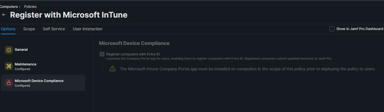

avagrace
  • Apr 5, 2026 11:51 AM UTC
This is a classic loop when setting up the Jamf-Intune integration. The issue is usually that the user is trying to sign into the Company Portal app directly, which doesn't trigger the necessary handshake between Jamf and Entra ID.
To fix this, you need to ensure the registration happens through Jamf Self Service:
  1. Stop Manual Sign-ins: Tell your users to stop opening the Company Portal app manually. It won't register the device correctly this way.
  2. Deploy the Registration Policy: Create a policy in Jamf Pro that uses the "Register with Microsoft Intune" payload.
  3. Use Self Service: Set this policy to be available in Self Service.
  4. The Correct Workflow: The user must open Jamf Self Service and click "Register" (or whatever you named the policy). This specific action launches the Company Portal with the necessary parameters to link the Jamf computer record with the Entra ID user record.
Once they finish the sign-in through that Self Service link, the "Get the app" loop should disappear and the compliance status will start flowing to Intune.
