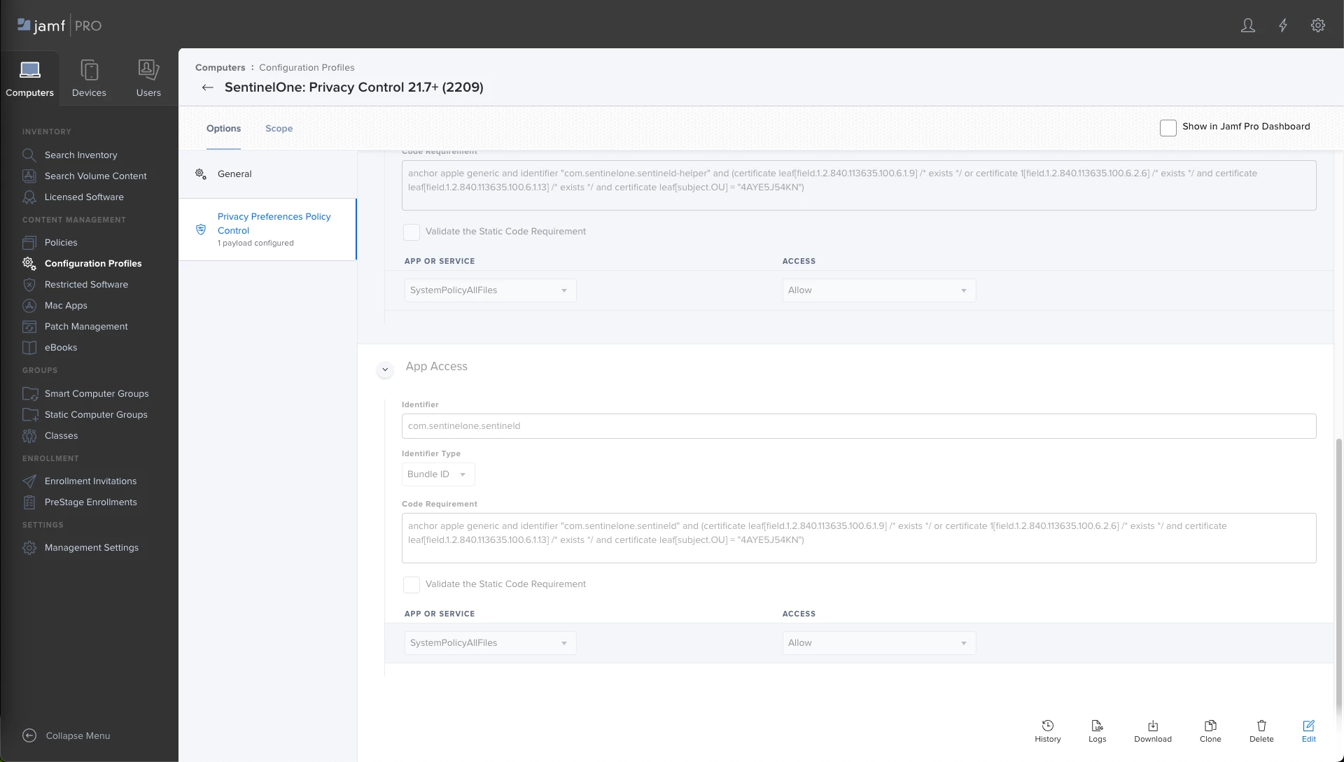

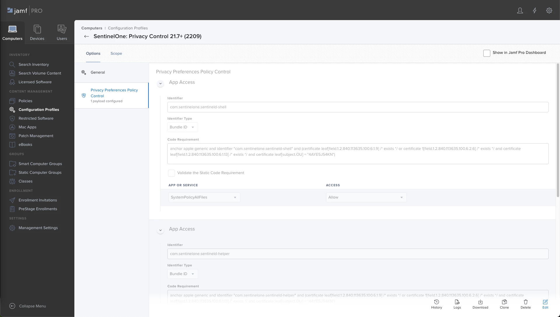

SentinelOnes Documentation covers this, you need to approve three items and give them SystemPolicyAllFiles access. I honestly recommend pinging SentinelOne as they have good documentation for macOS and even have JAMF specific documentation.
Below is what I use. I always hate when people copy paste screenshots with the code requirements I needed but you cant copy it. So I put the code requirement stuff in the code blocks.
  • com.sentinelone.sentineld-shell
ID: com.sentinelone.sentineld-shell Code Requirement: anchor apple generic and identifier "com.sentinelone.sentineld-shell" and (certificate leaf[field.1.2.840.113635.100.6.1.9] /* exists */ or certificate 1[field.1.2.840.113635.100.6.2.6] /* exists */ and certificate leaf[field.1.2.840.113635.100.6.1.13] /* exists */ and certificate leaf[subject.OU] = "4AYE5J54KN") App or Service: SystemPolicyAllFiles Access: Allow
  • com.sentinelone.sentineld-helper
ID: com.sentinelone.sentineld-helper Code Requirement: anchor apple generic and identifier "com.sentinelone.sentineld-helper" and (certificate leaf[field.1.2.840.113635.100.6.1.9] /* exists */ or certificate 1[field.1.2.840.113635.100.6.2.6] /* exists */ and certificate leaf[field.1.2.840.113635.100.6.1.13] /* exists */ and certificate leaf[subject.OU] = "4AYE5J54KN") App or Service: SystemPolicyAllFiles Access: Allow
ID: com.sentinelone.sentineld Code Requirement: anchor apple generic and identifier "com.sentinelone.sentineld" and (certificate leaf[field.1.2.840.113635.100.6.1.9] /* exists */ or certificate 1[field.1.2.840.113635.100.6.2.6] /* exists */ and certificate leaf[field.1.2.840.113635.100.6.1.13] /* exists */ and certificate leaf[subject.OU] = "4AYE5J54KN") App or Service: SystemPolicyAllFiles Access: Allow
