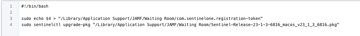

I have run into an odd issue where on some machines complete the S1 upgrade and some machine fail it after the agent is installed (hence the S1 console sees them online and on the correct version).  It seems like a permissions issue that I don't know how to tackle.

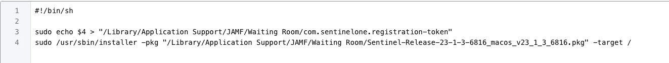

This is the install script - This is the one I decided on using.
This is the upgrade script - Alternate script

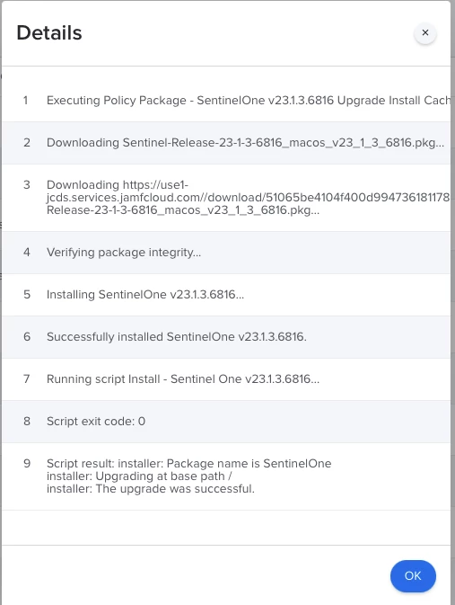

Successful.

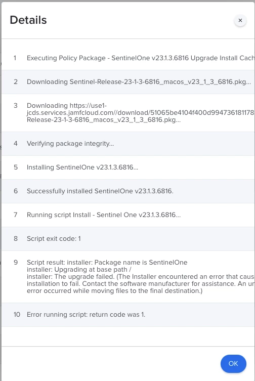

 Not successful.
 This is the error:
Script result: installer: Package name is SentinelOne installer: Upgrading at base path /
installer: The upgrade failed. (The Installer encountered an error that caus installation to fail. Contact the software manufacturer for assistance. An ur error occurred while moving files to the final destination.)
I guess I'm confused as to why it completed on 3 Macs but failed on 11 Macs.  Same script.  Same everything...
