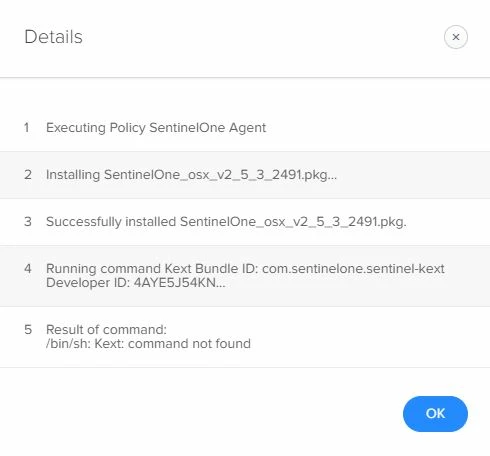

Good Morning jamf Nation,
We are rolling out SentinelOne agent to Macs. I have the policy set, but I need some assistance with "pre-approving" the SentinelOne Agent kernel extension. The S1 setup guide gives a parameter to enter in the policy:
Kext Bundle ID: com.sentinelone.sentinel-kext
Developer ID: 4AYE5J54KN
I just don't know where to put the parameter. I tried copying and pasting it into Execute Command under Files and Processes, but that change doesn't 'approve' the agent. Based on the log file, it looks like it's trying to run the parameter, but then fails?
Any ideas?

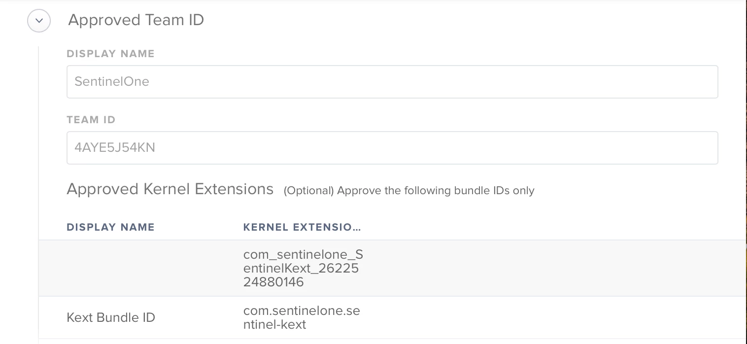

I put the kernel extension in a configuration profile and deployed that first then deployed the software.

Hey @edullum
We've got Configuration Profile to distribute SentinelOne pkg on Enrollment, and soon after we are running a script to activate.
Also, Inside Configuration Profile, scroll down to Approved Kernel Extensions And add as follow :
It takes 2-3 minutes to activate but it works. A user doesn't have to click to approve Kernel Extension inside Security & Privacy.
Hope this helps.

  • Aug 10, 2018 12:18 PM UTC
@rafalkukla We don't send a script to activate the agent. We deploy a policy to install the SentinalOne.pkg from our Distribution Share Point. I obtained the pkg from the S1 portal under Settings>Updates>OS X. We then see the client pop up in the S1 portal under Network>Default group. We then move the machine to the correct static group depending on what school the machine belongs to. I've seen the S1 agent fail to install a bunch of times. The log file says that it could not mount the Distribution Share Point....I hate that..it happens a lot and it happens randomly. Like 1 out of 5 computer enrollments.
I created a Smart Computer Group with criteria to put computers that don't have the S1 agent installed. When those computers get online the policy to install the S1 agent to better manage it.
Attached is a screenshot of what our S1 configuration profile looks like.

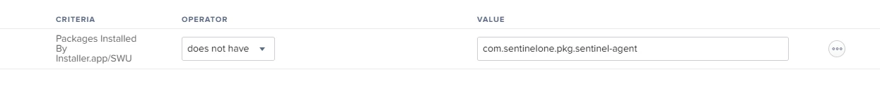

SentinelOne does not appear as an installed application. How can I create a smart computer group to tell me if SentinelOne is installed? It does run in memory as SentinalAgent, but there is no option to check for a running process.
  • Oct 4, 2019 6:55 PM UTC
Like this...
