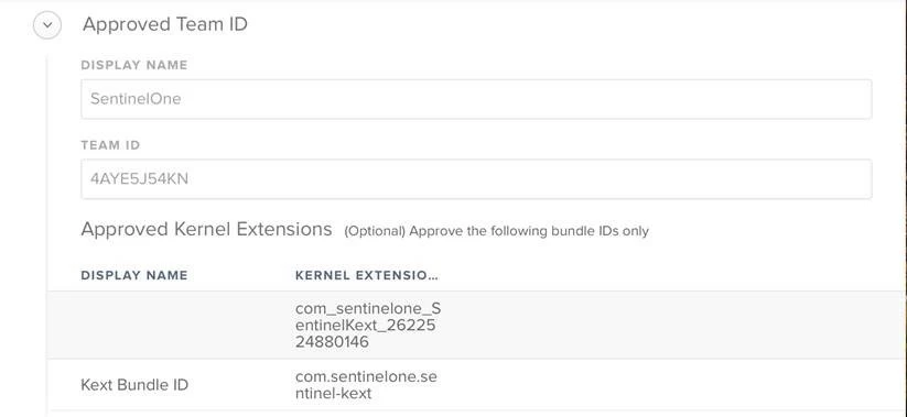

@ESensenbrenner I am experiencing the same thing. I can't get S1 version 3.0.4.2657 to install with a policy via Jamf cloud (10.15.1), but I have no problems installing it locally on the mac. There is first a Configuration Profile on the mac to approve the kernel extension. Then, I have a policy set to install the package via our network File Share Distribution Point (no spaces in file path). Package name also has no spaces. After the package is installed I run an Execute Command to set the registration token. However, I get an error message that the package failed to install and to contact the manufacturer, but only on some Macs not all. I've even downloaded a fresh pkg of the S1 agent and it's a no go.

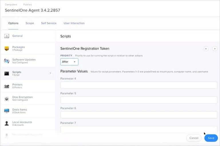

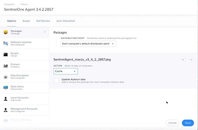

Installing and Upgrading macOS Agent with Jamf
Agents: macOS 2.6+ Jamf is macOS software to build packages, manage inventory and images, and run remote updates. You can use Jamf, or other MDM software, to install the SentinelOne macOS Agent.
During the installation, you must add Agents to a Site with the Site Token. From version Grand Canyon SP4, you can use a Group Token during installation, instead of a Site Token, to add Agents directly to a static Group in a Site. Get the Group Token from one Site > one Group > Network > Group Info.
To get the Site Token:
1. In the sidebar, click Scope and select a scope.
Select one Site. If you are in any other scope, the Site Token does not show.
2. In the Network toolbar, click Packages.
  1. In the Site Token section, click Copy.
To install with Jamf:
1. In the Network toolbar, click Packages.
  1. Download the PKG of the macOS Agent version to install.
  2. Launch Jamf and log in.
  3. Create a configuration profile with these values in the Approved Kernel Extensions:
    Kext Bundle ID: com.sentinelone.sentinel-kext
    Developer ID: 4AYE5J54KN
  4. Click Computer Management.
  5. Add the SentinelOne Agent PKG file to Jamf.
  6. Click Script and enter these lines, with your values for the Site or Group Token and package version:
  7. sudo echo "token" > /Library/Application Support/JAMF/Waiting Room/com.sentinelone.registration-token sudo /usr/sbin/installer -pkg /Library/Application Support/JAMF/Waiting Room/Sentinel-Release-version.pkg -target /
  8. Click Save.
  9. In Computers > Policies.
  10. Click Packages and change Action to Cache.
  11. Click Scripts and change Priority to After.
  12. Click Save.
    The Agent installs the next time the selected endpoints connect with Jamf.

@edullum Having the exact same issues with 3.4 and 3.6. I previously put the package into composer and ran the token script in composer then created a package. 3.2.1 and the new 3.2.3 works perfectly still. You can run those via command line. As soon as you run 3.4 and 3.6 via command line, that same error and contact the software manufacturer occurs. I've got a ticket open with Sentinelone but so far they've been less than helpful. Only pointing me to webpages I've already read and saying make sure my kext file is correct. My stuff has worked since March 2019, but doesn't work with 3.4 or 3.6. They haven't said what is different about their installers.
  • Feb 4, 2020 12:35 AM UTC
3.2.0, 3.2.1 and 3.2.6 (Jan 31st 2020 release date), will all work if the Kext is installed first, then you install the pkg as downloaded directly from sentinelone and then you do the token afterwards. If you run the pkg in terminal, it works.
My previously created composer pkg worked for these versions but not 3.4 or the 3.6 versions.
The old composer pkg, I copied the file to the /tmp folder. Then my post install said sudo /usr/sbin/installer -pkg /private/tmp/SentinelOne/Sentinel*.pkg
I then added the site token in that same pkg sudo /usr/local/bin/sentinelctl set registration-token --longtokenhere
Used this method for a year. This did not work with 3.4 and 3.6.
I piggybacked off awgingers post from October 29, 2019.
I copied the 3.6.1 pkg as downloaded from sentinelone to the /var/tmp folder. I then used textwrangler to create the "com.sentinelone.registration-token" file. The trick here, is it says a txt file. But when you save it into the same folder (in this case /var/tmp), you must not have it named with a .txt extensions. Remove the .txt from the end. It must only be named com.sentinelone.registeration-token.
Of course make sure your permissions are good to go. Then create your pkg in composer. This time the install will work. 3.4. and 3.6 requires the token to be a part of the install. 3.2.3, 3.2.1 and 3.2.0 and all earlier versions don't care if you put a token during the install. Those are all good to do afterwards.
Despite what sentinelone's instructions state, the way for 3.4 and 3.6 is to pkg together these files and not call them afterward. I didn't try peterjs solution.
