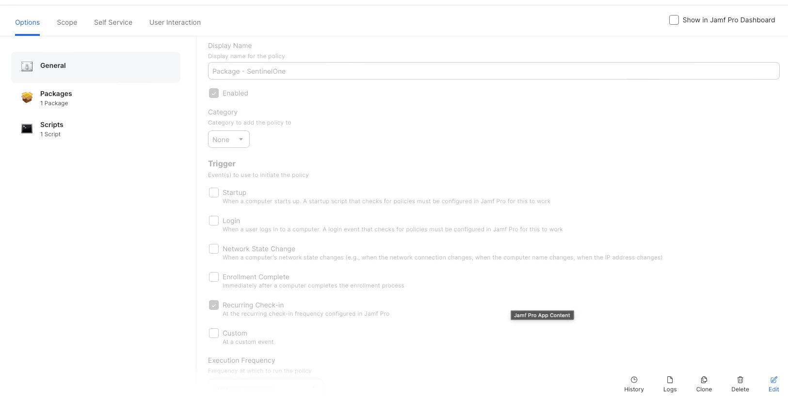

That's brilliant.  I will share some screenshots to make sure I'm setting it up like you suggest.  I am only scoping this for new installs by using smart groups.

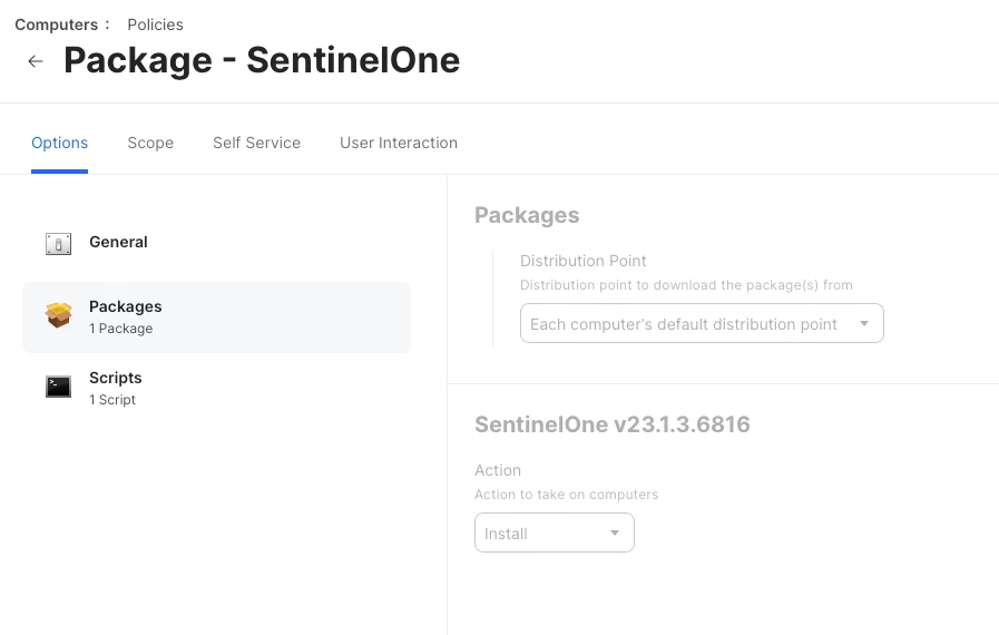

Be sure to set the package to Cache not Install. You need the package to be in the Waiting Room folder or the install will fail.
And you might want to blur out the key value in parameter 4. Don't really want that to be out in the public.
Thank you.  Thank you.  Thank you.  It worked perfectly today.
