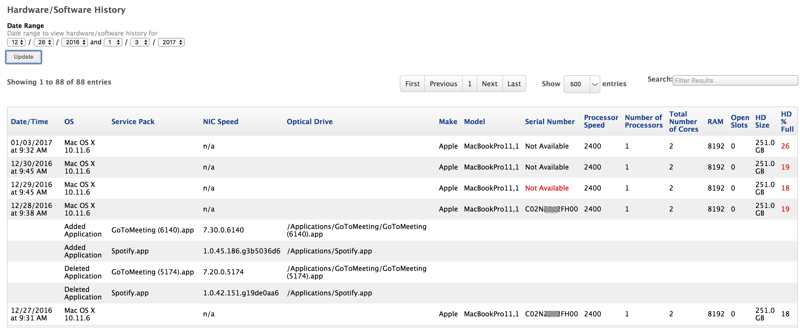

I just noticed that just one of our ~180 Macs started showing in JSS as serial number "Not Available" a few weeks ago. Laptop had been deployed about six months at that time. It continues to check in and provide inventory, but I don't have physical access to it right now. Looking in Hardware/Software History, I can see the first date this happened. There are one or two other old threads on this forum with no particular resolution. Is this something with the JSS or something with the laptop?

Though I have not heard back from this user, I find it hard to believe that the logicboard would find need to be replaced and then be replaced within 24 hours. If you look at that screenshot of the inventory reports, they don't miss a day through that period that the serial number report changed, daily between 9:30 and 9:45 am. Unless Apple Stores do "while you wait" logic board replacements? I guess it could happen. I am eager to find out what happened here and will update for those of you who are interested. Thanks.
