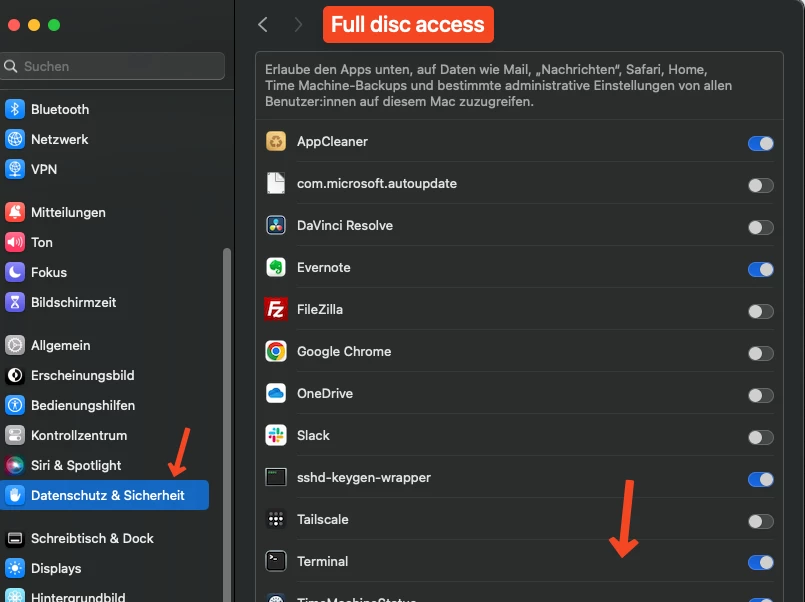

Hi,
Jamf is supporting default scripts for checking time machine backups. But with new versions of mac os this won´t work beuacse diskutil is using PlistBuddy. This has no disc access. If i enable Terminal in full disk access those scripts are working again.
Without disc access
With disc access
How can i set Terminal do full disc access via configuration profile?
Greets Frank

you don't want to grant terminal full disk access.. thats 'a bad idea'
not sure why plistbuddy is requiring access, but this does not.. you'll need to work that a bit to get the result you need, but you get the idea.
defaults read /Library/Preferences/com.apple.TimeMachine.plist | grep LastDestinationID
