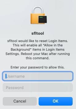

I am installing Maya 2024 and I am running into this popup.  I am able to get the license to verify via the network server when putting in my credentials.  I haven't tried on a non-admin machine.
I created a configuration profile with Managed Login Items, and added the Team Identifier/Bundle ID to it and deployed it to my machines and still getting the popup.  I've not seen this popup before.  Anyone have any info/experience on this?

Best answer by Jamfpire
I figured this one out, the version was updated back in December and I seem to have an older version.
  • July 9, 2024
