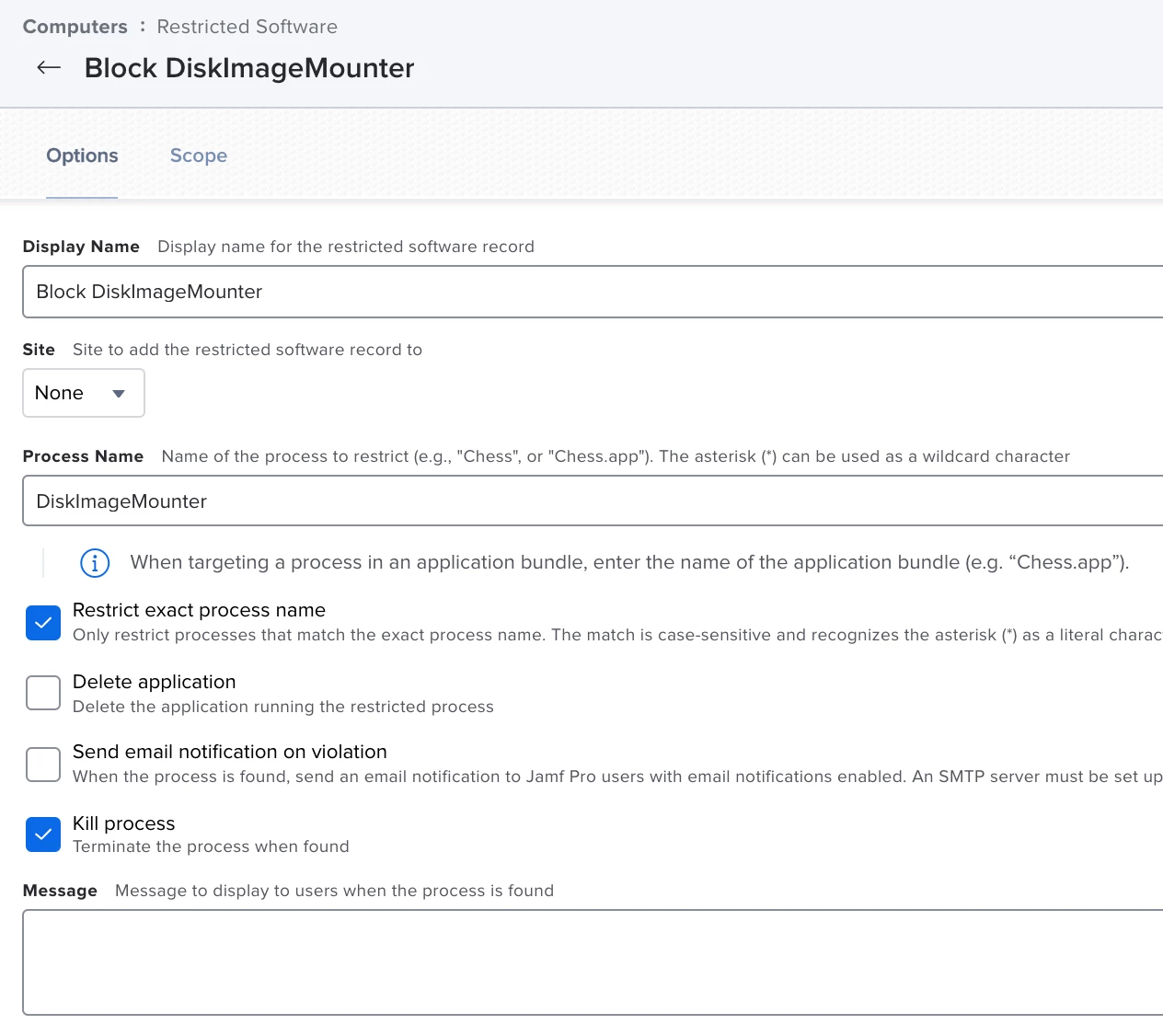

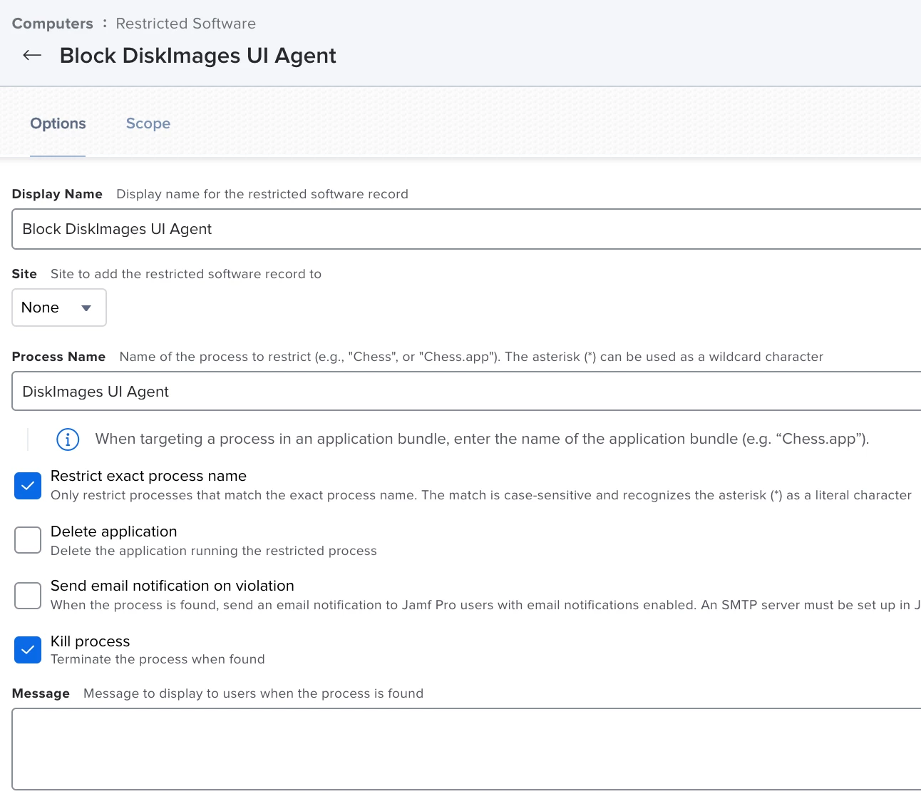

@janderson215
I actually did end up testing this, purely out of curiosity. I ended up creating 2 Restricted Software titles that seemed to do the trick. I'm posting screenshots of them here.
In my tests, these successfully blocked disk images from being mounted in the Finder with a double click operation. But because mounting a disk image on the command line uses a different process, those will still work, which most likely means (not tested) that a Jamf policy using a disk image as the package should still work. This isn't fool proof, because anyone with access to the Terminal and a little knowledge would still be able to mount the images and copy content off them. But it might act as a deterrent to casual app installs from the internet.
Hope those help.
