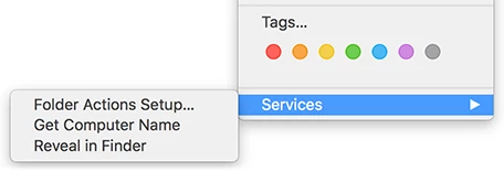

I have create a contextual menu to do this. I tried creating a Self Service Plug-In Bundle but I don't have much experience with Xcode so no luck there!
It's a simple right click on the Macintosh HD, select Services and Get Computer Name
Script added to Automator app:
appLocation="/Library/Application Support/JAMF/bin/jamfHelper.app/Contents/MacOS/jamfHelper"
popup="hud"
title="Computer Name"
heading="Your Computer Name is..."
description=$(scutil --get ComputerName)
button1="OK"
icon="/System/Library/CoreServices/CoreTypes.bundle/Contents/Resources/com.apple.led-cinema-display-24.icns"
"$appLocation" -windowType $popup -title "$title" -heading "$heading" -description "$description" -button1 "$button1" -icon "$icon"
Push out the workflow file via a policy.
