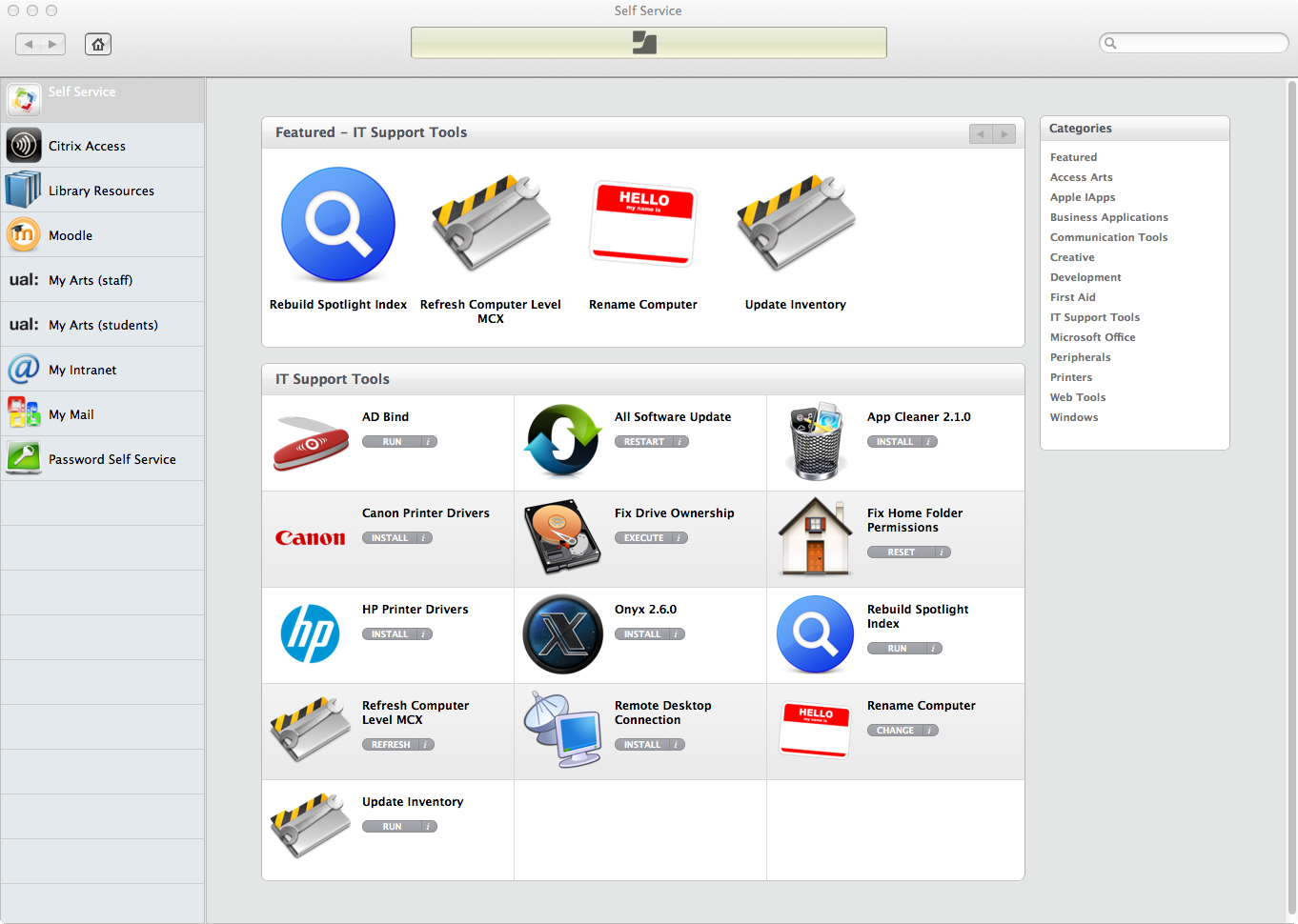

One good turn deserves another ...
external image link
I'm particularly proud of the rename computer icon ...

  • Dec 16, 2013 9:35 PM UTC
@franton... lol nice.. are the plugins links that open in Safari? I tried to add a site that uses a java plugin & no-luck :(
franton
  • Dec 16, 2013 9:47 PM UTC
They originally all opened in Safari ... now they just open in the Self Service window by request.

  • Dec 16, 2013 10:02 PM UTC
@franton, so the Citrix one uses the Citrix Receiver plugin?
(Must retry..)
franton
  • Dec 16, 2013 10:09 PM UTC
@bentoms][/url We just install Citrix Receiver 11. The address links to our citrix access website and it works from there. No special configuration needed. It's just an https address!

  • Dec 16, 2013 11:44 PM UTC
Disclaimer: I work for an arts and design university.
I would suggest using png files at 256x256 resolution for your self service icons. Find or make these files with alpha channels enabled and a transparent background. They'll look more polished if done right.
My fav trick is doing a Cmd + I on an app bundle, select then copy the icon into preview, resize and save as a png. Looks great and no hunting on google image search!
