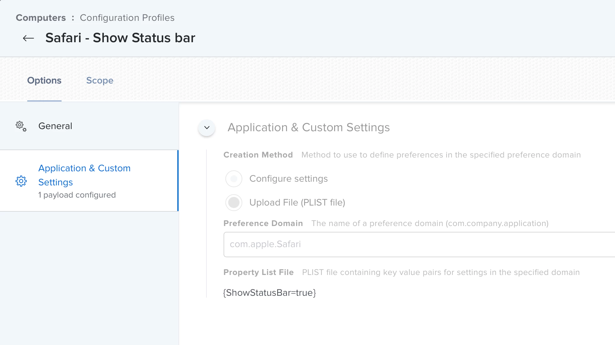

You could also consider using a Configuration Profile to manage this, especially if its something you'd like to enforce. The above command will only set the preference once - the user can easily switch it back off.
  • Jun 18, 2020 1:12 PM UTC
Yeah we have been looking into this recently. I tried using a Configuration Profile. It works, but if the end user switch it off it does not restrict or re-apply the "on" setting.
