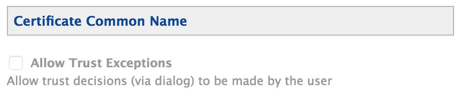

For those have issues, in the trust section of your configuration profiles delivering your payloads are you trusting by common name or by exact certificate name?
If you're trusting by common name, that's probably what the issue is. Make sure that box is unchecked and check to trust exact certificate and see if it's resolved.
  • May 16, 2017
@perrycj Our trust section in the config profile is blank. For the trust section, would this be the certificate required to connect to wifi? In our case, we use machine certificates requested from AD. How do I specify the exact certificate name in a configuration profile when all the certificate names are different?
  • May 16, 2017
dumb question? Where's the "Trust" section? It must be right in front of me, but I can't find it!
Thanks!
