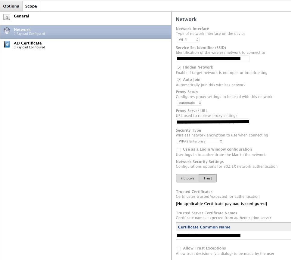

@mbezzo It's in the wifi payload of the configuration profile. Scroll to the bottom and click the Trust tab.
  • May 16, 2017
@bbot - ahhhh, thank you. :)

So it appears the change is that we must explicitly tell the supplicant (via network payload trust tab) what radius server(s) it is authorized to provide the cert to (either by trusting the radius server's CA or inputting server names). Before it worked without this. You will probably have to add that cert to your certificate payload if the radius server's cert is signed by a different CA than your client cert.

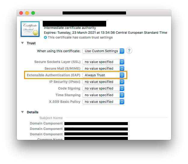

Hi all,
We encounter the same problem, no connection to our WiFi possible.
The WiFi network is cert based.
What seems to be working: (suggested by @nwiseman )
Set in the Trust Section of that certificate EAP to "Always trust"
I tried to handle that inside the Configuration Profile, but that wasn't working at all (it even disabled the Workaround). What am I doing wrong here?

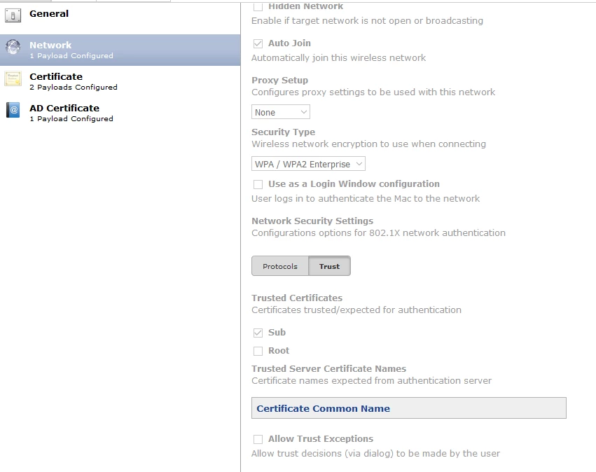

@dpratl I deploy my root and intermediate certs as a part of the same profile and they show up under Trusted Certificates and allow me to check them as trusted.
  • May 17, 2017

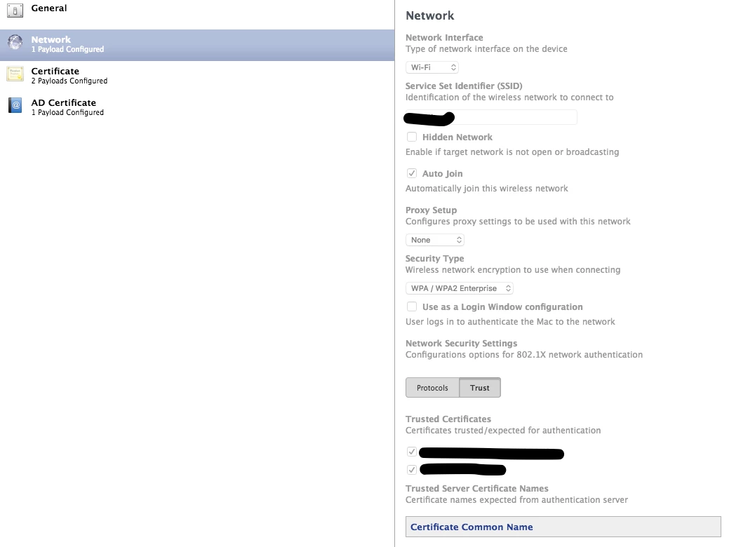

Still running into some issues here. On my test machines, I am unable to connect to WiFi completely after checking the Trust box for the intermediate certificate.

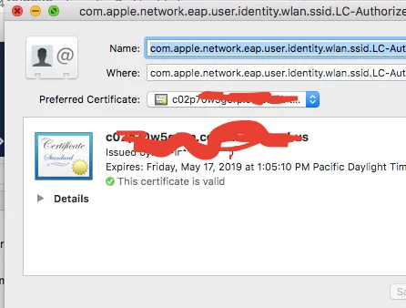

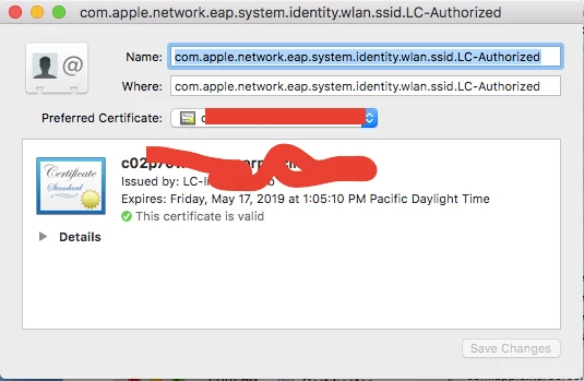

Can someone review my config? This is getting installed on the computer level. AD certificate is requesting for a machine certificate to authenticate. Certificates are requesting properly, it creates the com.apple.network.eap.user.identity.wlan.ssid in keychain and assigns the appropriate certificate.
On 10.12.5, I can have the user re-install the current configuration profile (without the intermediate box trust checked), and it'll re-connect to wifi fine. It's just that the wifi disconnects after updating to 10.12.5.
I also have a separate configuration profile that deploys just the root + intermediate certificates to the system keychain. (these have been on the Mac prior to the wifi config profile being deployed)
  • May 17, 2017
@bbot you need to trust the root and sub, also I'm trusting by exact cert name where you have 'root' and 'sub' and it's working here.
  • May 17, 2017
No dice. I've tried trusting both certificates, and adding the common names into the trust.
I've tried going into keychain, right clicking the certificates and setting the trust to "Always Trust" and it still won't connect to wifi... so I'm not sure if the issue is with the intermediate and root.
  • May 17, 2017
We trust both the root and the sub (which are included in the profile) in the Network payload and it has been working fine for us on our 10.12.5 testers.
  • May 17, 2017
@bbot are the certs getting installed and marked as trusted?
  • May 17, 2017
@jason.desveaux the root is marked as Always Trust all the way down the list. The Intermediate is marked as valid, trust is set to use system defaults and no value specified. This is after marking them both as trusted in the configuration profile.
The messed up part is even after manually trusting the intermediate, it still won't connect.
The only way I can get it to connect to wifi is if none of the boxes are checked in the configuration profile.
  • May 17, 2017
@bbot strange... is your identity preference in the keychain pointing at a trusted cert?
  • May 17, 2017
Looks fine to me. I have both system and login keychain.
