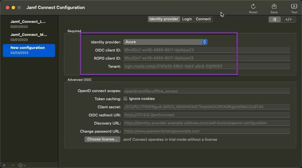

All of this is configurable. I am betting you have something configured wrong, I recommend checking your com.jamf.connect configuration profile. The screen you are seeing is coming from your IDP source, JAMF Connect is just displaying the webpage it is being told to display by the IDP. If everything looks correct in JAMF Connect ping your JAMF Rep for assistance. If this is what your Azure instance is telling JAMF Connect to display, reach out to your TAM for assistance with Azure.
Integrating with Microsoft Azure AD - Jamf Connect Administrator's Guide | Jamf
With your POC you should have gotten the JAMF Connect Configuration app. The IDP settings are in the Identity Provider tab.

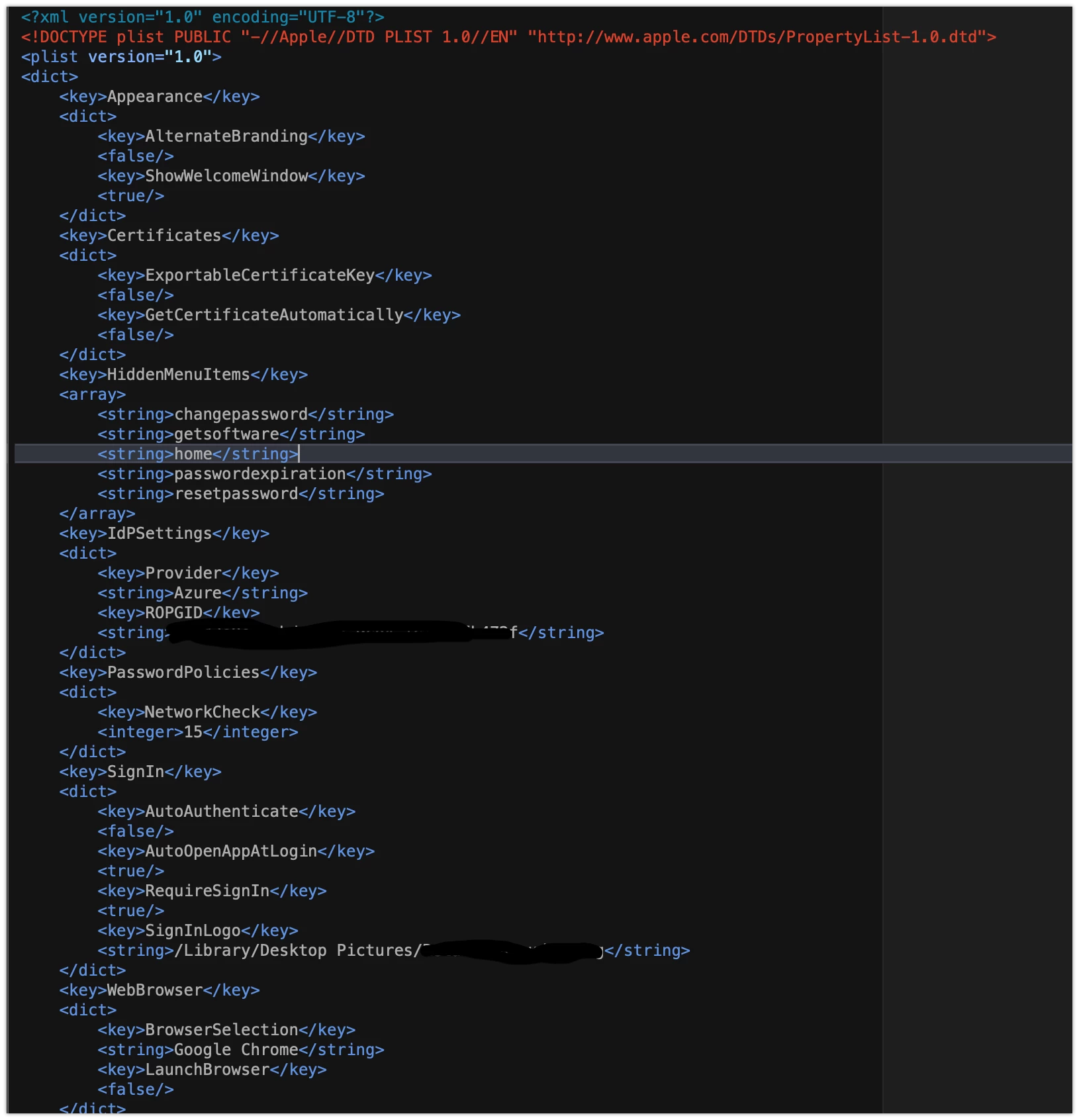

I build my profile using Jamf Connect Configuration and can't see any sign-in options in there !!

I couldn't see anything related to sing-in options in com.jamf.connect config profile
The only thing in there is "RequireSignIn" which has nothing to do with the problem I'm having.
I searched well in our Azure AD and couldn't find anything configured to sign-in with Github! but I still doubt it's from Azure AD side not JC.

Honestly, its probably a configuration on the Azure side. JAMF Connect is just displaying the options it is being told to display from Azure. JAMF Connect itself is a reliably simple application.
Have you tried to disable the signin with GitHub option on your Azure Tennant?

Yeah that's in azure. You saw the Microsoft sign-in page in a webview window and opted for alternate sign-in options in that window. Whatever happens in that window is Azure.
