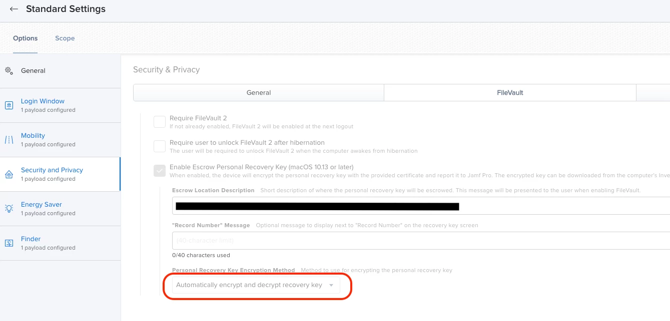

General answer from support: Certificates from the internal CA are managed automatically when they are in use.
We didn't use them, even we had one in a Configuration Profile:
But in the same ConfProfile we set up the FileVault Personal Recovery Key Encryption Method to "Automatically" (red in the screenshot) - that means the Built In Cert is used automatically, not the one we have added to the ConfProfile:

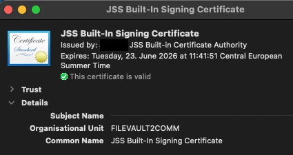

After removing the expired Cert from the ConfProfile and distributing to my Testclient a new Cert was shown:
All seems to work, these certs didn't have any effect on our Macs.

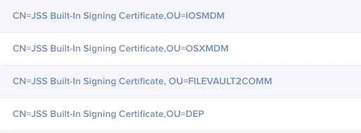

all 4 of these are about to expire for me and I can't find any documentation on how to renew them. so if you found out do let me know.

@dpratl have you received any reponse to your ticket?
All the certificates listed by @TheWarmAtlantic above are expired for us as well.
