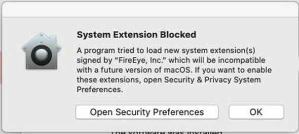

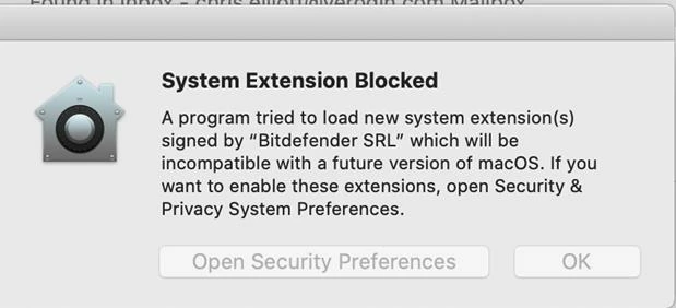

Last week our cyber security team provided us the newest Fireeye client for Mac OS 11.
Installing via Jamf Pro Cloud pkg is causing a dialog for the user to consent to the P2BNL68L2C.com.fireeye.helper system extension.  It's the same dialog on a standard install.
We've testing out the initial app install and get an install prompt that requires manual intervention. Even added P2BNL68L2C.com.fireeye.helper to system extensions, approved kernel extensions to see what would happen: Intervention was still required. We’ve been pretty liberal with the PPPCs and have had the prior kext which doesn’t appear to be used in Big Sur both included and not.
When reaching out to Fireeye support they initially offered assistance after a few emails gave a blanket "Silent uninstallation with MDM solutions is not currently supported on macOS 11.".  They plan on adding support in future releases.
Prior versions of the Fireeye Client for Mac OS packaged and performed silent installs without issue and we're hoping someone here has seen and figured a work around.

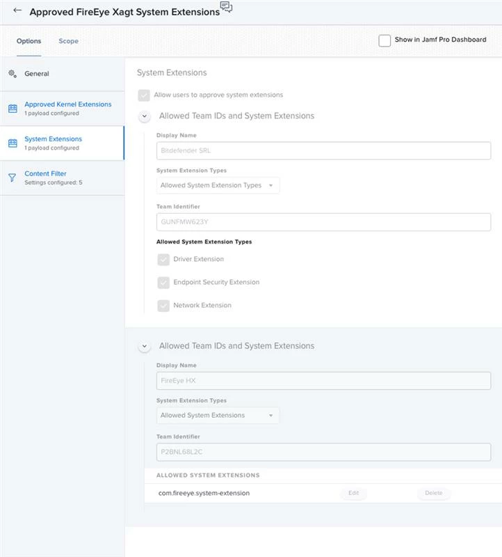

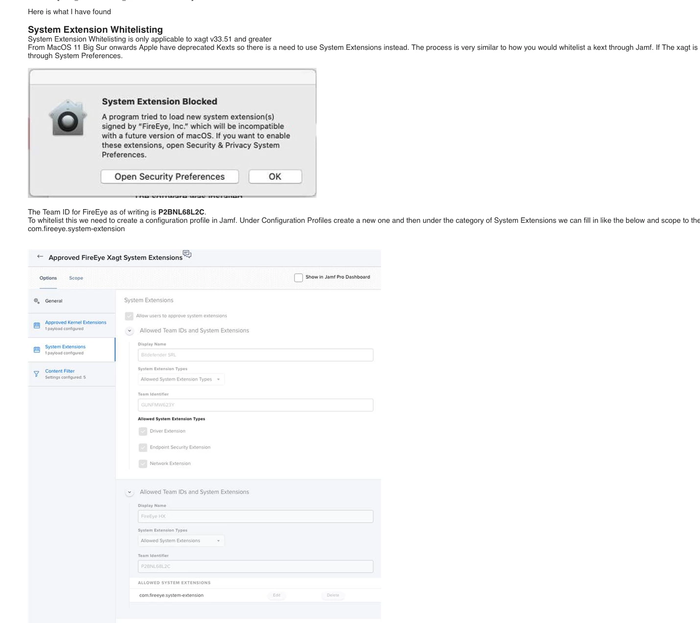

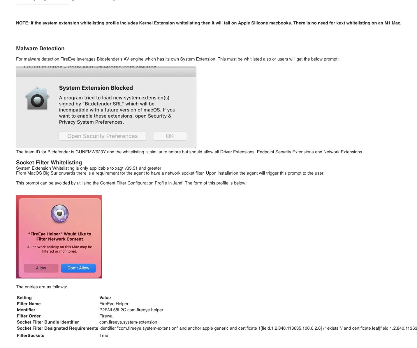

Hey Folks,
I have resolved our issue of receiving the System Extension "content" block and also the FireEye Network Filter pop up.  After many hours of research, testing and a phone call to FireEye I finally have the ingredients to silently upgrade/install version 33.51.10 to Big Sur.
**Note - we do not use BitDefender
** These are not  all of my notes**.
I also left my previous PPPC profile on which allowed Full Disk Access to xagt.  Which basically included every service.  It does not hurt to have more than you needed.  You can also check with your CSIRT team to see what they needed scanned.
System Extension Whitelisting
System Extension Whitelisting is only applicable to xagt v33.51 and greater
The Team ID for FireEye as of writing is P2BNL68L2C.
You can get this ID from drawing the FE client into PPPC Utility. It will reveal the code and Team ID, which then you can use for deployment.
To whitelist this we need to create a configuration profile. The specific extension name for the xagt that should be whitelisted is com.fireeye.system-extension
Malware Detection
For malware detection FireEye leverages Bitdefender’s AV engine which has its own System Extension. This must be whitlisted also or users will get the below prompt:
The team ID for Bitdefender is GUNFMW623Y and the whitelisting is similar to before but should allow all Driver Extensions, Endpoint Security Extensions and Network Extensions.

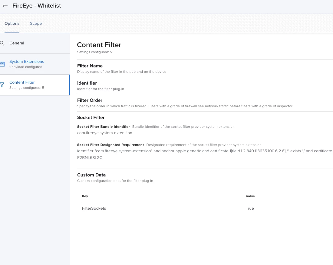

Socket Filter Whitelisting
From MacOS Big Sur onwards there is a requirement for the agent to have a network socket filter. Upon installation the agent will trigger this prompt to the user:
The entries are as follows:
SettingValue
Filter NameFireEye Helper
IdentifierP2BNL68L2C.com.fireeye.helper
Filter OrderFirewall
Socket Filter Bundle Identifiercom.fireeye.system-extension
Socket Filter Designated Requirementsidentifier "com.fireeye.system-extension" and anchor apple generic and certificate 1[field.1.2.840.113635.100.6.2.6] /* exists */ and certificate leaf[field.1.2.840.113635.100.6.1.13] /* exists */ and certificate leaf[subject.OU] = P2BNL68L2C
FilterSocketsTrue

This is a really useful write up and thank you for that. I do have one question. I go to add the Socket Filter Whitelisting and all the fields you identified are there, with the exception of FilterSockets. I'm entering it in the payload for Content Filtering in the configuration profile, but perhaps I'm supposed to be entering it elsewhere.
Again, thanks so much.
  • September 16, 2021
Hello Mlarsen
Glad the write up helped.
You need to add the entry under Custom Data
You add the FilterSockets under Key then add True under Value.

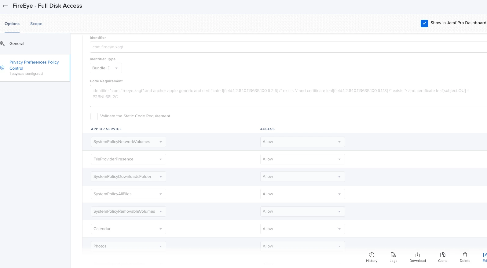

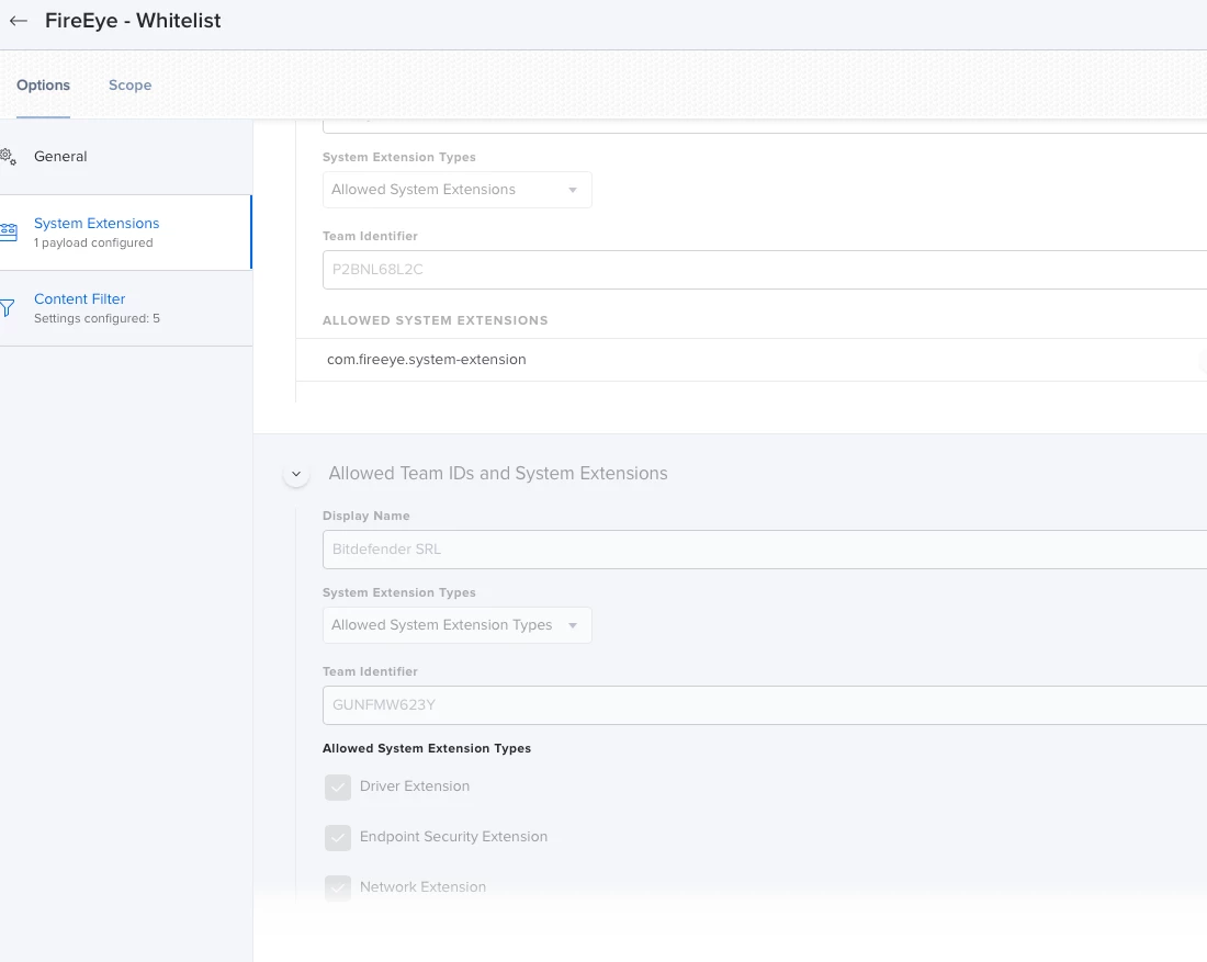

Our Profiles.
 System Extension
Content Filter.
FE Documentation

@mlarson  Sorry I didn't follow up with documentation.
Do the attachments I just added to the post resolve your issue?
Cheers,
mlarsen
  • October 27, 2021
Cheers,
Hi @pueo, The screenshots look good and I was able to get it resolved from the FireEye community page I linked to earlier. Thanks again for all the help you've provided.

We've been trying to get this upgrade to v.33.51.1 for more than a month and it's still failing for us...Engaged some FireEye tech for this issue and he sent the same guide that you provided the screenshots from, but it doesn't seem to go through the installation, failing somewhere while running the xagtSetup (see below):
"Installing FireEyewPostinstall v.33.51.1 PROD.pkg...
                Successfully installed FireEyewPostinstall v.33.51.1 PROD.pkg.
                Running script FireeyePostinstall v.33.51.1...
                Script exit code: 1
                Script result: installer: Package name is FireEye Agent
                installer: Installing at base path /
                installer: The install failed. (The Installer encountered an error that caused the installation to fail. Contact the software manufacturer for assistance. An error occurred while running scripts from the package “xagtSetup_33.51.1.pkg”.)
                Error running script: return code was 1."
Again, I've already created the required Config Profiles as per the FireEye guide, still No Bueno! 😞
Any ideas?
