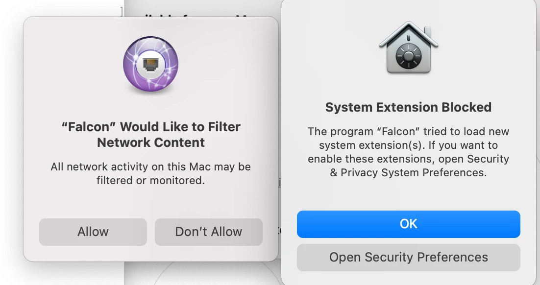

Has anyone successfully deployed Crowdstrike Falcon on Big Sur silently? Perhaps this is not possible?
I'm using the Falcon Profile.mobileconfig provided by Crowdstrike and pushing that out first, but it doesn't seem to suppress any of the pop ups or notifications. Also, the MDM profile doesn't seem to allow full disk access, which is necessary for Falcon to auto update itself.

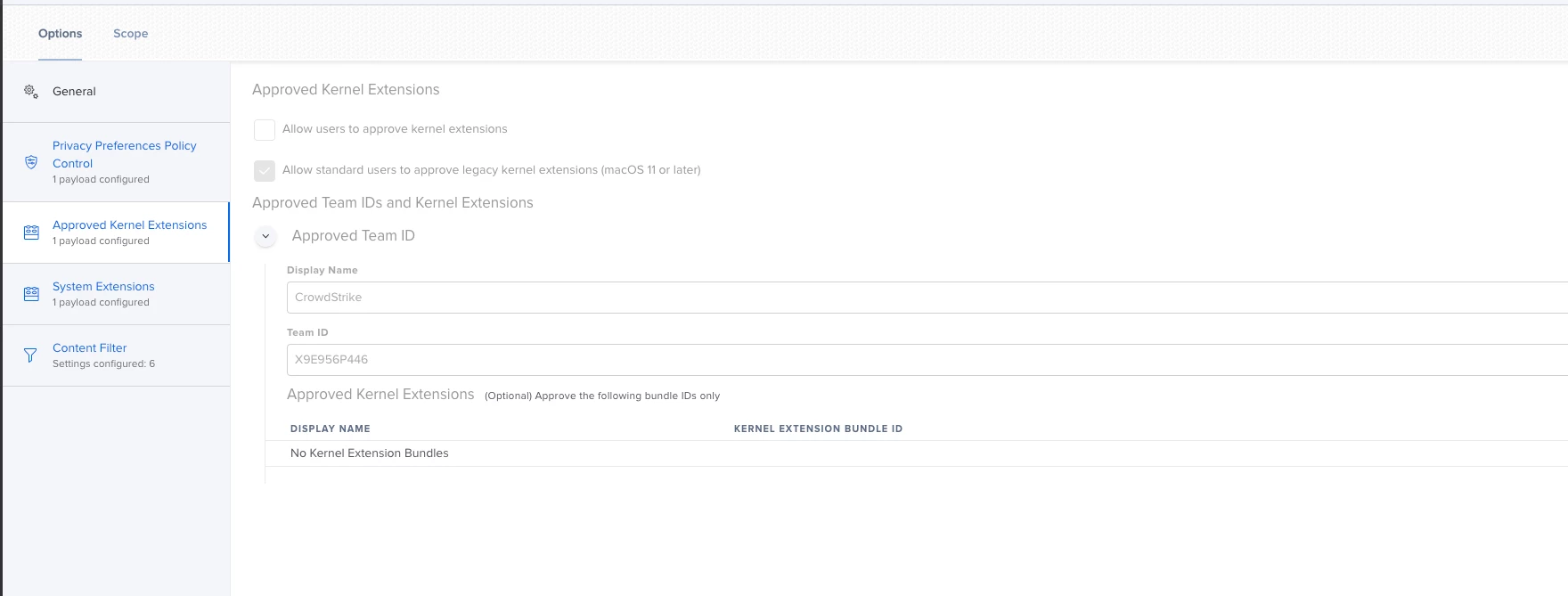

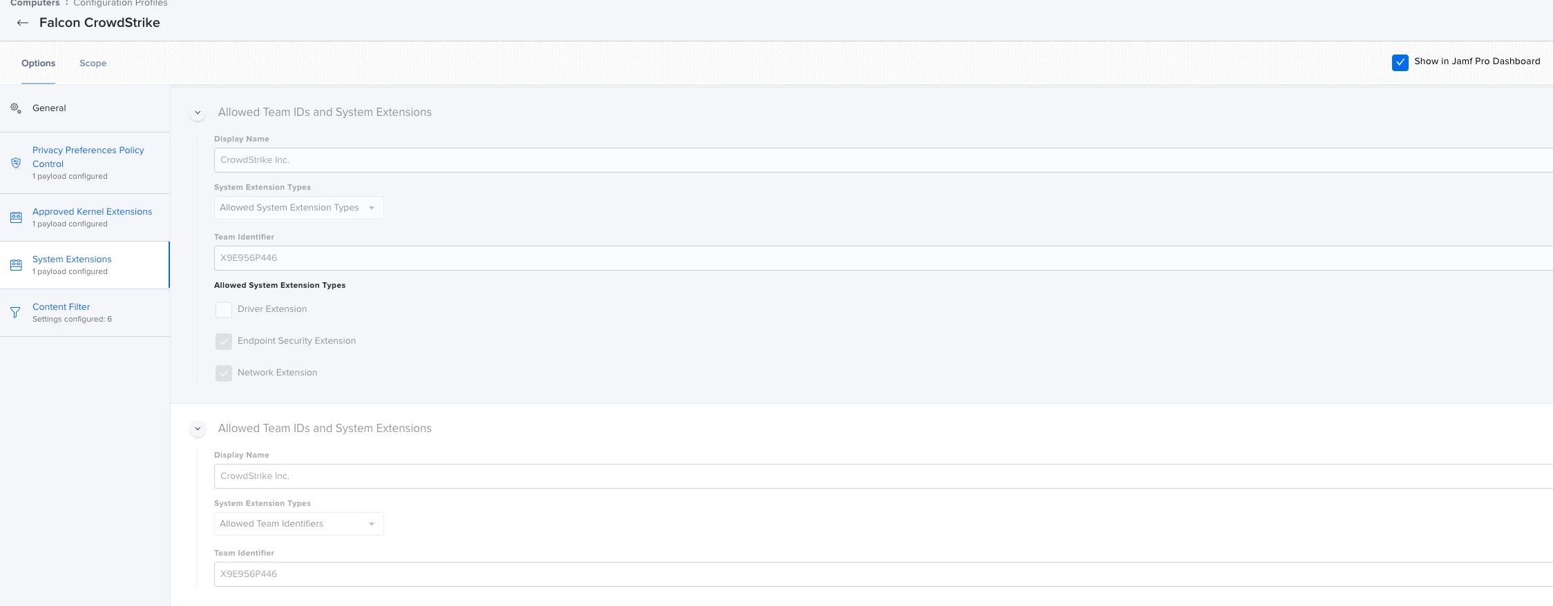

Hi @boatymcboatface ..
I currently have deployed CS in my environment .. so far you can only suppress both System Ext + Network filter but not the Notification ..
Hop the below images help!

@rkeleghan Thanks so much for this, it is great to have it all laid out and easy to follow.
I built my config just as you have shown, applied it, installed Falcon, and activated it.  Falcon is running and CS sees the new host, however in SysPref > Privacy, the Agent is still unchecked for Full Disk Access.  I had thought that the PPPC settings were specifically supposed to allow that?

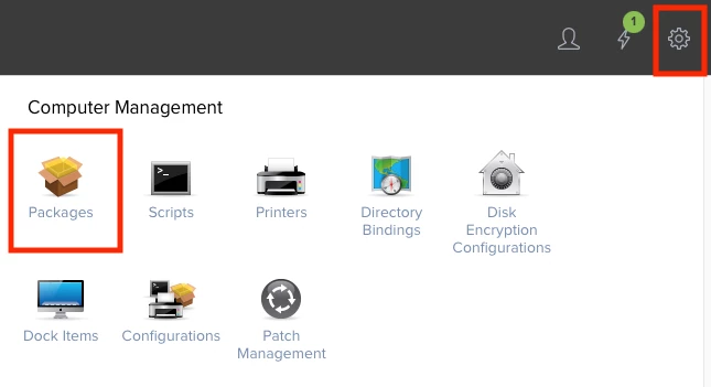

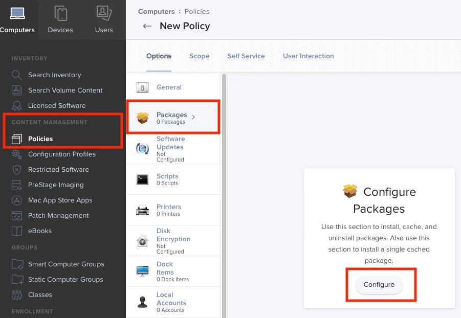

Sure, before making a policy you will need upload your package into your JAMF portal, to do so, log in to your JAMF page and click on the gear/settings icon at the top-right. Scroll down to the "Computer Management" section and click on "Packages"
Select your .PKG file and upload. Once uploaded, it may take a minute or two to fully sync. You can then go back into your Policies, create a new Policy, configure the "Packages" payload and select "Configure" to choose the PKG file you just uploaded
Once you save and scope your policy to your test machines, you should be able to see the installation go through. Per Crowdstrike's documentation I also added a short script to license and activate Falcon after installation similar to below:

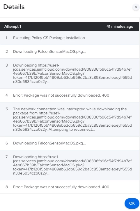

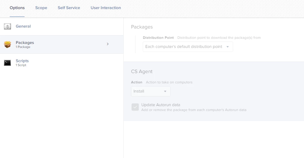

Thanks @kvmart I followed the configuration profiles from @rkeleghan and policy to install package as you stated. The configuration profiles were successfully pushed on the target machine however push of the package is failing.
Package installation profile
Package installation failed with errors below
It looks like its failing to download. Any idea? Thanks for helping

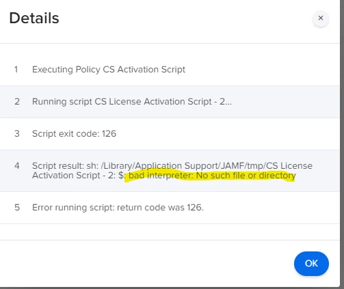

just to share - the package is now deployed successfully however then latest error i'm getting is shown in the screenshot.
This error appears whenever i tried to activate the falcon using the script from Jamf. It looks like Jamf is looking for a directory that doesn't exist.

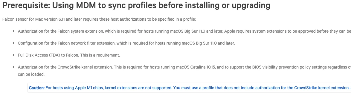

Are you pushing the kernel extensions and system extensions in the same config profile to both M1 and Intel? I am setting up for deploying and was told to break out system and kernel extensions from each other
  • Feb 11, 2022 10:26 PM UTC
I was deploying a single config profile with system and kernel extensions to all devices running MacOS 11 and above (M1 and Intel). Good to know that I should separate those. Thanks. Could you send a screen shot of the difference between those two config profiles you're using?
According to their docs is warns of not using a profile that includes kernel extensions on M1 machines

Hey,
The configuration profile for Crowdstrike for M1 and Intel based macs should be separate due to the fact that M1 don't support Kernel extensions.
So basically the Config Pro for M1 is the Intel Config Pro minus the kernel extension.

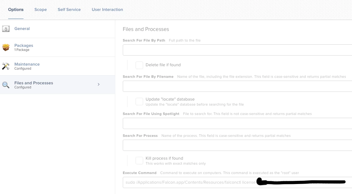

In the policy used to deploy CS, you can add this line of code in the "Files and Processes" for the licensing:
sudo /Applications/Falcon.app/Contents/Resources/falconctl license XXXXXXXXXX-YY
where XXXXX-YY represent your license (see my screenshot)
I believe you're adding a script on its own when one line of code was enough.
It also looks like your script is grabbing or deploying the license to the wrong location.
Let me know if this help.
It looks like you were having some connectivity issues that interrupted your deployment.
One good suggestion to keep in mind when it comes to these type of "heavy" deployments, is to maybe use one policy to "cache" the pkg and then another policy to deploy it.
That way, even if the user looses connection, the deployment will be able to complete.

  • Feb 19, 2022 12:04 PM UTC
Thank you!
I had a separate script for license activation.
I tried yours and it worked perfectly.

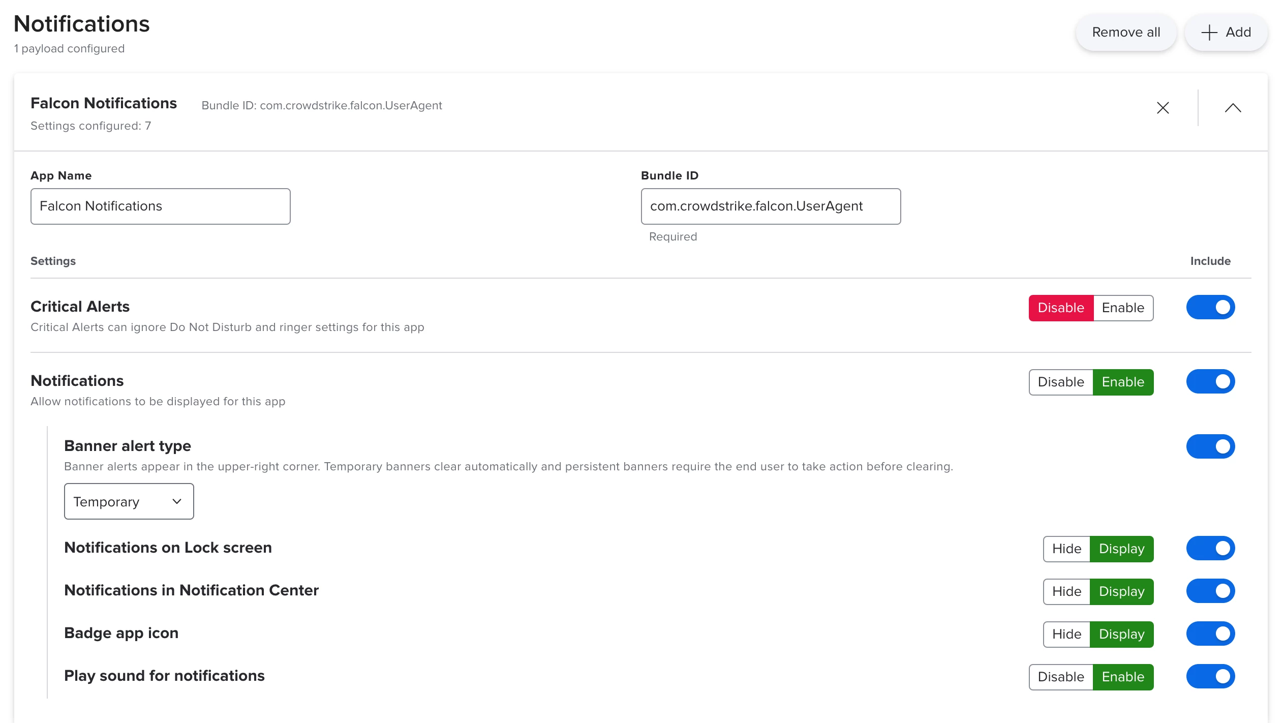

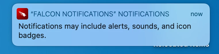

Late to this post, but I'm doing this now and thought I'd share about the notifications:
  • It looks like "Falcon Notifications" is a separate app from "Falcon" and is located here: "/Applications/Falcon.app/Contents/Library/LaunchServices/Falcon Notifications.app"
  • The bundle ID from that app's Info.plist file is "com.crowdstrike.falcon.UserAgent"
  • Using that bundle ID in a config profile notifications payload took care of things for me.
This worked perfectly thank you!
