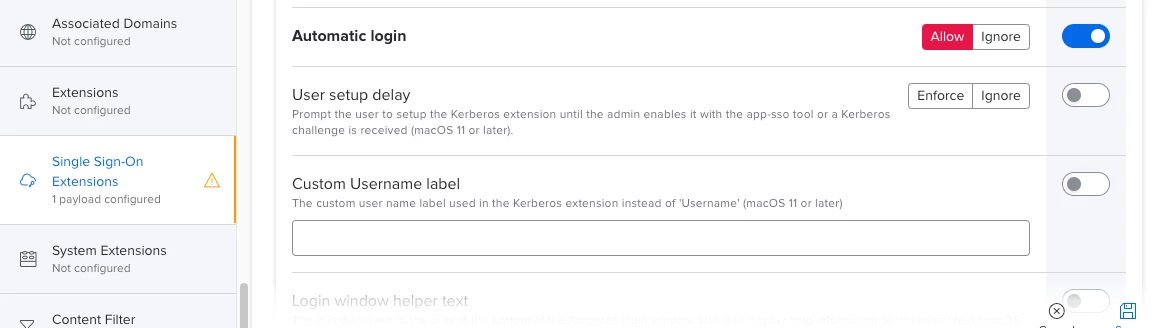

  • February 12, 2021
Is this how you have it set up? Mine is not reconnecting automatically and I am on 11.2.1
  • April 27, 2021
Just to follow up, I think my configuration profile was corrupt. I copied it to a new one and deleted the old one, and everything worked as expected.
