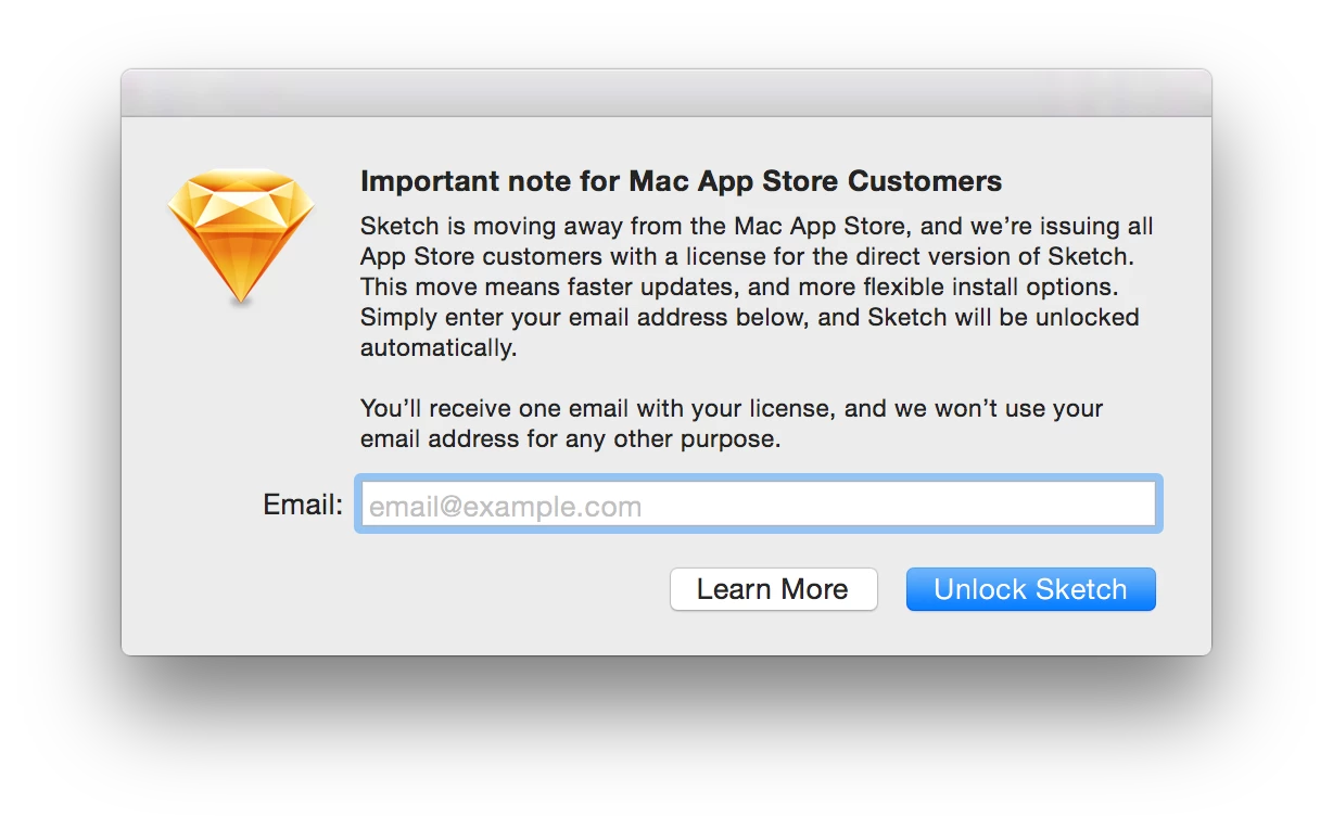

Have any of you found a way to disable the pop up prompt for an email address? We migrated our VPP tokens to a single serial number, but on first launch users are still presented with this dialog box and the only way to dismiss it is by entering an email address.
After a user enters their (or ANY, I have one person with asdf@asdf.com) email address, the app will license itself based on the .deployment file containing the key. Then, a separate 1 seat key will be mailed from Bohemian Coding automatically.
I've been sending these extra keys to Bohemian to invalidate, but I'd prefer not to have to bother my users with it or suck up their support time.
