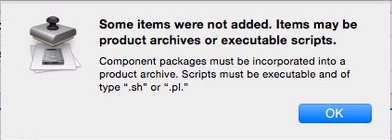

I get this error trying to add the .pkg files
What's int he pkg file you've made?
I made a user account and the skip the apple setup both two .pkg files.

When I follow your guide for the scripts what format do I save them as.
Do they have to be part of a .pkg file to work. I got the admin account to work but now need to skip the iCloud,timezone and all of that stuff.
David can you help me get the script customized?
I seems to need it to be part of a .pkg file to even run is there a way to just put in a script in system image utility.
Hi @kericson
The script needs to be run on first boot of the new OS. If you are using Casper, you just add the script to the Casper Admin configuration and set it to run at reboot once the imaging has finished.
If you are using something like DeployStudio you can use that to run a postponed script.
Failing that, you would need to package it and run it via a LaunchDaemon that delete after completion.
