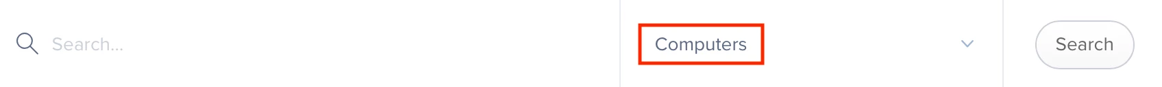

If you don't care about losing the data then yes, drop the database, create a new one and grant permissions. When tomcat is restarted it will recreate the tables. I am curious, when you do your computer search does the dropdown show that you're searching for computers?

Hi @leslie Yes - the dropdown is set for computers but a good thought. I've been in the wrong area before with the search.
