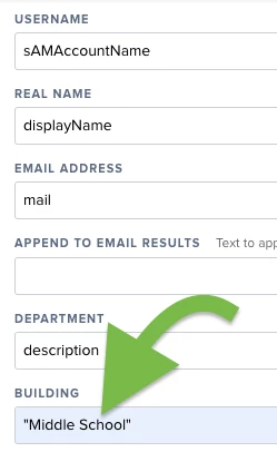

@cdenesha Do you know if there's a way to include a string constant instead of an LDAP attribute in the LDAP Server --> User Mappings settings? (eg. I want Building to map to a constant like "Middle School" rather than the physicalDeliveryOfficeName LDAP attribute).
  • April 26, 2019
@robert.petitto No I don't think this is possible - it is an LDAP configuration so needs the LDAP attribute.
