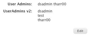

OK I left the old script in place for "User Admins" attribute and created the EA "User Admins v2" with your script. There are three accounts on this system, the test account is a standard account. The output was identical whether I used
#if [[ $(dsmemberutil checkmembership -U "${username}" -G admin) != not ]]; then
OR
#if [[ ! $(dsmemberutil checkmembership -U "${username}" -G admin) =~ not ]]; then
here is the output
