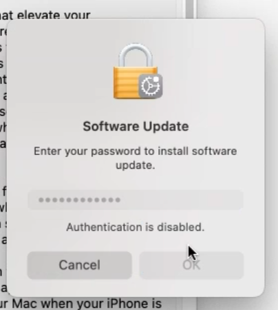

dlondon
Just wondering if anyone has seen this.
 The machine is Ventura (Mac OS 13.6) and trying to upgrade to Mac OS 14.1
Machine is bound to an AD domain and the user has a secure token and is an administrator on the machine.  The user is logged on with a domain account i.e. a mobile account.  The machine is an M1
I tried forcing the update/upgrade via Jamf using the MDM framework from the server as they are overseas but it got to the end of preparing and prompted them again
Best answer by dlondon
Sorry, I did get a solution to this.  It’s not always enough to enable the Secure Token.  The secure token can have a password that is different to the logon password.  For example if you have Microsoft AD bound Mac’s and change the user passwords on a system that is not the Mac’s i.e. a special server for password changes.  Mac OS doesn’t play well with that method of changing the password when it comes to Secure Tokens.  When the password is changed externally, the Secure Token will still have the previous password.  This behaviour is different for keychains - in that case the machine recognises the password change at next logon and prompts for the old password, then changes the logon keychain password to be the new logon password.  Unfortunately the same thing is not done for Secure Token hence it prompts when trying to do something like run updates that requires a Secure Token as the Secure Token password is now different to the logon password.
The only way out is if you have another account on the machine that has a valid secure token and the password is known.  You can use that in conjunction with the user who must enter their new password.

Below post can help you. Since authentication is not failed but disabled which might be due to issue with secure token.
https://community.jamf.com/t5/jamf-pro/softwareupdate-is-trying-to-authenticate-user-authentication-is/m-p/245357
sdagley
  • Nov 28, 2023 1:37 PM UTC
@dlondon If send the update command with a user deferral option it'll always prompt for credentials. Use the option to download and install immediately to perform the update without user prompting. You might also want to have the user restart that Mac if it's been up more than 7 days as that seems to be the threshold (at least in my environment) when macOS Ventura starts to have issues with the MDM pushed update command.
dlondon
  • Dec 7, 2023 7:20 AM UTC
Thanks @sdagley and @user-rLcbGKzEGV the user is overseas and has been out of contact since I asked them to check a few things for me.
I'm going down the secure token rabbit hole to see if setting it off and then back on will have any effect.
Steve - I did try the MDM command via Jamf and install immediately without prompting but nothing happened.  I will check on the restart before doing the update comment to see if that helps.
  • Jan 16, 2024 6:55 AM UTC
Hi,
I have tried Re-enabling the Secure Token.
Still the error is same
Kindly help on the same
Thank you
dlondon
  • Jan 13, 2026 6:41 AM UTC

exit 1
prompt_for_password() {
local prompt_title="$1"
local prompt_message="$2"
local field_label="$3"
local result=""
local password=""
result="$(launchctl asuser "$CONSOLE_UID" sudo -u "$CONSOLE_USER" "$DIALOG_BIN" \
--title "$prompt_title" \
--message "$prompt_message" \
--icon "$ICON_FILE" \
--textfield "$field_label",secure,required \
--button1text "Continue" \
--button2text "Cancel" \
--small \
--ontop \
--json 2>/dev/null)"
if [[ $? -ne 0 ]]; then
return 1
password="$(printf '%s' "$result" | plutil -extract "$field_label" raw -o - - 2>/dev/null)"
if [[ -z "$password" ]]; then
return 1
printf '%s' "$password"
validate_local_password() {
local username="$1"
local password="$2"
dscl /Local/Default -authonly "$username" "$password" >/dev/null 2>&1
if [[ ! -x "$DIALOG_BIN" ]]; then
echo "ERROR: SwiftDialog is not installed at $DIALOG_BIN"
exit 1
if [[ -z "$CONSOLE_USER" || "$CONSOLE_USER" == "root" || "$CONSOLE_USER" == "loginwindow" ]]; then
echo "ERROR: No logged-in user was detected"
exit 1
if [[ -z "$CONSOLE_UID" ]]; then
echo "ERROR: Unable to determine the UID for $CONSOLE_USER"
exit 1
if [[ -z "$ADMIN_USER" ]]; then
fail "A local administrator account was not supplied in Jamf parameter 4."
if ! dscl /Local/Default -read "/Users/$ADMIN_USER" RecordName >/dev/null 2>&1; then
fail "The local administrator account '$ADMIN_USER' does not exist on this Mac."
if [[ "$ADMIN_USER" == "$CONSOLE_USER" ]]; then
fail "The repair administrator must be different from the affected user."
if ! sysadminctl -secureTokenStatus "$ADMIN_USER" 2>&1 | grep -q "ENABLED"; then
fail "The administrator account '$ADMIN_USER' does not have a Secure Token."
if ! dseditgroup -o checkmember -m "$ADMIN_USER" admin | grep -q "yes"; then
fail "The account '$ADMIN_USER' is not a local administrator."
if ! sysadminctl -secureTokenStatus "$CONSOLE_USER" 2>&1 | grep -q "ENABLED"; then
fail "The account '$CONSOLE_USER' does not currently have a Secure Token."
while true; do
USER_PASSWORD="$(prompt_for_password \
"Secure Token Repair" \
"Enter your current computer login password. The password is needed to repair the workstation." \
"Login Password")" || exit 1
if validate_local_password "$CONSOLE_USER" "$USER_PASSWORD"; then
break
USER_PASSWORD=""
show_message "Incorrect Password" "The login password was not accepted. Please try again." "SF=exclamationmark.triangle.fill,color=orange"
done
if [[ -n "$PARAM_ADMIN_PASSWORD" ]]; then
echo "Using the administrator password supplied through Jamf parameter 5"
ADMIN_PASSWORD="$PARAM_ADMIN_PASSWORD"
if ! validate_local_password "$ADMIN_USER" "$ADMIN_PASSWORD"; then
ADMIN_PASSWORD=""
PARAM_ADMIN_PASSWORD=""
fail "The administrator credentials supplied through Jamf parameters 4 and 5 were not accepted."
else
while true; do
ADMIN_PASSWORD="$(prompt_for_password \
"IT Administrator Authentication" \
"An IT administrator must enter the password for '$ADMIN_USER' to authorize the Secure Token repair." \
"Administrator Password")" || exit 1
if validate_local_password "$ADMIN_USER" "$ADMIN_PASSWORD"; then
break
ADMIN_PASSWORD=""
show_message \
"Incorrect Password" \
"The administrator password was not accepted. Please try again." \
done
echo "Turning off Secure Token for $CONSOLE_USER"
TOKEN_OFF_OUTPUT="$(sysadminctl -secureTokenOff "$CONSOLE_USER" -password "$USER_PASSWORD" -adminUser "$ADMIN_USER" -adminPassword "$ADMIN_PASSWORD" 2>&1)"
if sysadminctl -secureTokenStatus "$CONSOLE_USER" 2>&1 | grep -q "ENABLED"; then
echo "$TOKEN_OFF_OUTPUT"
fail "Secure Token could not be disabled for '$CONSOLE_USER'. No additional changes were made."
echo "Secure Token disabled for $CONSOLE_USER"
echo "Turning on Secure Token for $CONSOLE_USER"
TOKEN_ON_OUTPUT="$(sysadminctl -secureTokenOn "$CONSOLE_USER" -password "$USER_PASSWORD" -adminUser "$ADMIN_USER" -adminPassword "$ADMIN_PASSWORD" 2>&1)"
echo "$TOKEN_ON_OUTPUT"
fail "Secure Token was disabled but could not be re-enabled for '$CONSOLE_USER'. Contact IT before restarting this Mac."
echo "Secure Token enabled for $CONSOLE_USER"
USER_PASSWORD=""
ADMIN_PASSWORD=""
if ! diskutil apfs updatePreboot / >/dev/null 2>&1; then
fail "Secure Token was repaired, but the FileVault Preboot information could not be updated."
show_message \
"Secure Token Repaired" \
"The Secure Token was refreshed successfully. Restart the Mac, sign in, and try Software Update again." \
"SF=checkmark.circle.fill,color=green"
echo "Secure Token repair completed successfully for $CONSOLE_USER"
