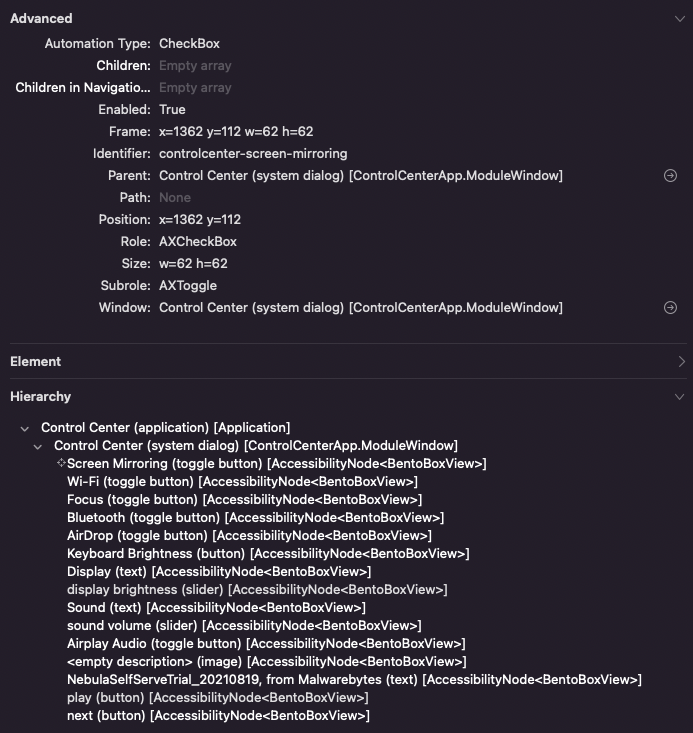

First script: Clicking on Screen Mirroring in the Control Center.
The intent is to open Control Center, then click on Screen Mirroring to show available options as part of the user troubleshooting process. Script editor acts like the script I have is supposed to work, but nothing happens after Control Center opens.
The applescript:
tell application "System Events" tell application process "Control Center" tell menu bar item "Control Center" of menu bar 1 click end tell delay 1 tell window "Control Center" tell checkbox "Screen Mirroring" click end tell end tell end tell end tell
What Automator's Watch Me Do says:
-- Click the menu bar item. delay 1.994947 set timeoutSeconds to 2.000000 set uiScript to "click menu bar item \\"Control Center\\" of menu bar 1 of application process \\"Control Center\\"" my doWithTimeout( uiScript, timeoutSeconds ) -- Click the “Screen Mirroring” checkbox. delay 1.300753 set timeoutSeconds to 2.000000 set uiScript to "click checkbox \\"Screen Mirroring\\" of window \\"Control Center\\" of application process \\"Control Center\\"" my doWithTimeout( uiScript, timeoutSeconds ) on doWithTimeout(uiScript, timeoutSeconds) set endDate to (current date) + timeoutSeconds repeat try run script "tell application \\"System Events\\" " & uiScript & " end tell" exit repeat on error errorMessage if ((current date) > endDate) then error "Can not " & uiScript end if end try end repeat end doWithTimeout
What Accessibility Inspector Shows for Hierarchy (Screen Mirroring is actually checkbox 5):

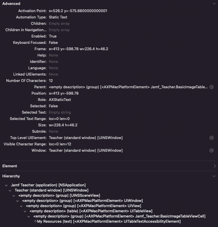

Second script: Clicking on My Resources in Jamf Teacher.
The intent is to open the Jamf Teacher app and go to My Resources to show scoped apps (as we are on Jamf School). The problem here being I am only getting index errors when running the script. Using the Press action from the Accessibility inspector acts as it should. Automator's Watch Me Do is also inconsistent with what shows in the hierarchy.
The applescript:
tell application "Jamf Teacher" activate end tell delay 3 tell application "System Events" tell application process "Jamf Teacher" tell window "Teacher" click static text 1 of group 4 of table 1 of group 1 of group 1 of group 1 end tell end tell end tell
What Automator's Watch Me Do says (notice, no table in hierarchy):
-- Click the text element. delay 2.501810 set timeoutSeconds to 2.000000 set uiScript to "click static text 1 of group 4 of group 1 of group 1 of group 1 of group 1 of window \\"Teacher\\" of application process \\"Jamf Teacher\\"" my doWithTimeout( uiScript, timeoutSeconds ) on doWithTimeout(uiScript, timeoutSeconds) set endDate to (current date) + timeoutSeconds repeat try run script "tell application \\"System Events\\" " & uiScript & " end tell" exit repeat on error errorMessage if ((current date) > endDate) then error "Can not " & uiScript end if end try end repeat end doWithTimeout
What Accessibility Inspector says (notice, table is shown before last group):
Big thanks to anyone that takes the time to look at this nonsense.
