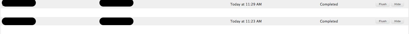

Just curious if anyone else has seen this - only appeared in the past couple of days that I've noticed.
Policy is fairly simple, it is just installing all cached software for systems in a smart group based on an EA which specifically checks for installers in the WaitingRoom directory.

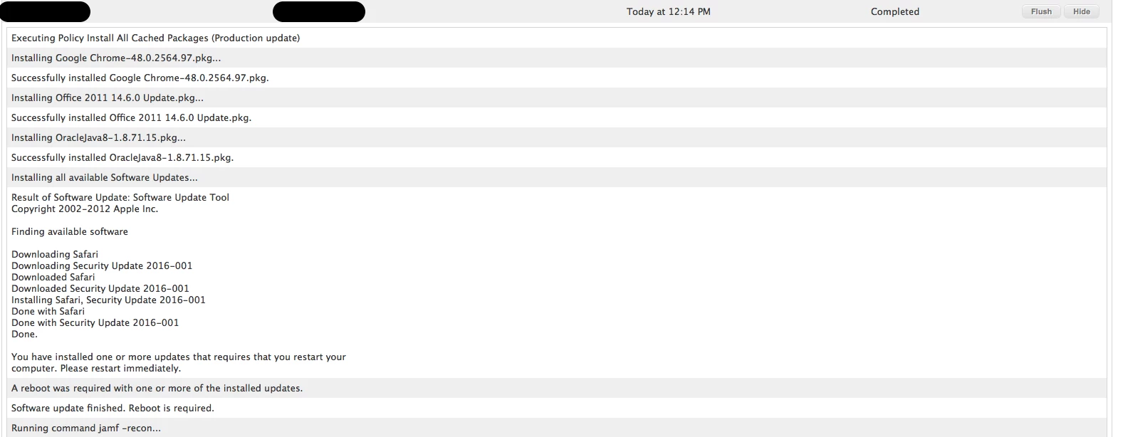

Most machines return the expected result: (first image)
For others, I'm seeing a completely blank entry as shown here.
Again, I've only noticed this in the past 48 hours or so, but may have just not been paying attention.
JSS 9.82, clients are a mix of 10.9 and 10.10.

Looking a bit closer today, I've flushed the logs, and the same systems keep popping up with the issue. The "install cached" is based on a smart group which simply checks to see if the packages are cached, so it seems that the packages exist, but the "install" policy isn't doing anything on those systems that I can see.
I'm going to flush the "cache" policies and see if re-downloading the package changes anything, but curious to know if I'm the only one seeing this.
